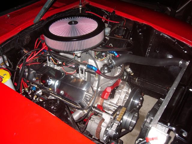

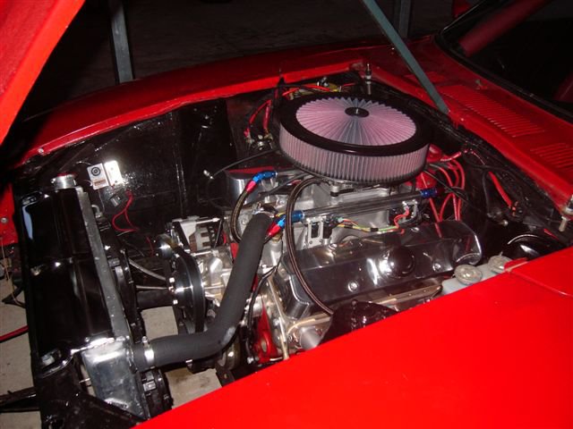

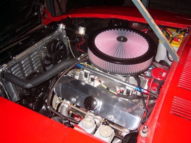

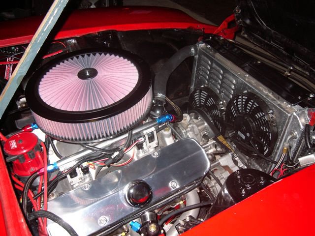

rytherwr Posted January 31, 2007 Share Posted January 31, 2007 Made some changes to the hotrod...I believe the intake was restricting air flow (when I replaced the 1050 carb with the FI, the system came with a standard Victor Jr) I had the World products intake modified with some bungs and put the system back together with a little coo-coo juice for those steep on-ramps. I set a goal to drive it to the track, break into the fives, (1/8th mile track) and drive it home. I'm doing this on a 10:1 motor running 93 octane pump gas. I drove the car today and sure feels like it breathes easier. If the weather holds, I will test it out this Sunday...wish me luck. Wayne PS...pls excuse my highly engineered, custom hood prop....gotta paint it red for SEZ 8...) Quote Link to comment Share on other sites More sharing options...
z-ya Posted January 31, 2007 Share Posted January 31, 2007 Wayne, It looks like you have a nice clean installation there. What engine management are you using? Quote Link to comment Share on other sites More sharing options...
rytherwr Posted February 1, 2007 Author Share Posted February 1, 2007 Thanks for the prop, z-ya...I appreciate...Hate to admit this in public, but it is an EECIV system same as a 88-93 Mustang. Running a modified corvette MAF that sits under the air cleaner with a signal conditioner box between it and the EEC so it can read the signal. Works very well...best time with the old manifold was 6.70 in the 1/8th on street drag radials. Wayne Quote Link to comment Share on other sites More sharing options...
