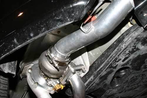

proxlamus© Posted March 15, 2007 Share Posted March 15, 2007 first off go to http://www.ststurbo.com Quote BENEFITS!# Ease of installation. STS turbo systems can be installed in about 8 hours with standard tools and average mechanical ability. # Performance Sound. The turbo acts as a muffler and sounds like an aftermarket performance muffler. Turbo spool and rushing air from the blow-off valve make a unique sound that will turn heads! # No need for major modifications to your vehicle. STS systems are designed to "bolt-on" to factory mounts. # Increased gas mileage. Unlike a belt driven supercharger, the turbo utilizes "wasted" energy leaving your tailpipe. Most of our customers get 1-3 mpg increase in gas mileage. # Lower underhood temperatures. No need to worry about melting wires, hoses, or other components. # Converts back to stock in about an hour. # More room under the hood. Future repair work or modifications will not require the expense of removing the turbo system to allow access to engine components. # Cooler oil to the turbo. Cool oil is better for both the turbo and engine. # Approximately 500F lower turbo temperatures. Eliminates the need for a turbo-timer, which allows the engine to run after the car is shut off in order to cool down the turbo and prevent oil and bearing damage. # Denser exhaust gasses drive the turbo turbine wheel more efficiently. # Built-in intercooling. Intake piping provides ~50% intercooler efficiency. There is no need for the expense, pressure drop, and installation problems associated with a front mounted intercooler. # Turbo is exposed to ambient air rather than underhood air. Allows for better cooling of turbo components. # No need for expensive headers, mufflers, or exhaust systems. # Turbo is closer to the tail pipe outlet. Provides a better pressure differential across the turbine wheel which promotes better flow across turbine. # Better weight transfer. Increases traction because the bulk of system is mounted in rear of vehicle rather than up front. # Less noise in the passenger compartment. Quote With the turbo so far back, don't you get a lot of turbo lag?No, our turbochargers are sized to operate at this remote location. Just like any turbocharger, once the turbo is up to temperature and in the rpm range for which it was designed to operate. The boost comes on hard and fast. All of our systems will produce full boost below 3000 rpm. If you were to take a conventional turbo and place it at the rear, you would have lots of lag and consequently, our turbo wouldn't work properly if mounted up front. These are pictures from 280z nick from Zcar.com one main addition to a standard turbo setup. you will need an external oil pump. Quote Link to comment Share on other sites More sharing options...

veritech-z Posted March 15, 2007 Share Posted March 15, 2007 You need an extremely small A/R I think, since you lose so much heat(and therefore energy that would otherwise go into spooling your turbo) in order to compensate. Also, you'll need some kind of electric scavenger pump for your oil so that it will continue to pump after you shut the car off to avoid coking the bearing up. You probably won't need an intercooler since your tubes will be so long to get back to the front of the car. Something I always wondered about was what about puddles? Even if you mount your air filter someplace where it wouldn't be in danger of picking up water, what if you were driving for awhile, and had a super hot turbo, then hit a puddle and splashed it with cold (relatively) water? Wouldn't it crack? If you look between the lines at www.ststurbo.com you can get a good feel for the type of design features that they are using. As an example, this is a detail picture of a turbo they are selling for 6.0 liter GTO. look how small the exhaust housing looks, bearing in mind this is a SIX LITER V-8. Here you can see what they had to do: they've converted it to single exhaust somewhere towards the front of the car, and then at the yellow arrow that I've added in they split it back out by using a large external wastegate. The wastegate dump tube is now the second exhaust tip. The pink arrow shows you where the turbo is. Notice how close the air filter is to the wheel. That's GOT to pick up all kinds of crap from the road (I know my cold air intake on my Altima that's between the fascia and the inner fender liner up front picks up tons of dirt, so this completely open filter has got to have it at least that bad...) If that's the size you need for a 6.0 V-8, imagine how small you would likely need to get similar performance out of an engine less than half the displacement... *edit* Wow, you guys beat me to that one! posts 4,5,and 6 appeared while I was typing that up... Quote Link to comment Share on other sites More sharing options...
veritech-z Posted March 15, 2007 Share Posted March 15, 2007 Hey Prox, what is the AN fitting in the back of the valve cover for, do you know? That's not the oil return, is it? I find their comment about "no expensive exhaust system" kind of funny, since the GTO I posted right from their website clearly has a completely custom exhaust... Quote Link to comment Share on other sites More sharing options...

veritech-z Posted March 15, 2007 Share Posted March 15, 2007 The reason it's small is because if it weren't small, it wouldn't work back there. I've seen a Camaro with a rear mount turbo, and it was pretty fast. As long as you design the system around it, there is no real reason it wouldn't work. I just don't like the complexity of plumbing in the electric oil pump (what if it fails? you wouldn't know until it was too late). Plus it makes me nervous to run oil lines that far down under the car, right next to the drive wheels. I wonder if you couldn't get an external oil cooler, a catch can, and a small electric pump and just give the thing it's own rear mounted oil system totally independant of the main engine oil system? Quote Link to comment Share on other sites More sharing options...

280zwitha383 Posted March 15, 2007 Share Posted March 15, 2007 I like the setup because it doesn't run a muffler and the wastegate having the other part of a dual exhaust is pretty cool. Quote Link to comment Share on other sites More sharing options...
240zwannabe Posted March 15, 2007 Author Share Posted March 15, 2007 280zwitha383 said: I like the setup because it doesn't run a muffler and the wastegate having the other part of a dual exhaust is pretty cool. before i changed my mind, i wouldn't have run a muffler and would have done something similar to that wastegate setup except it would've been out the side. Quote Link to comment Share on other sites More sharing options...

G.I.jonas Posted March 18, 2007 Share Posted March 18, 2007 I agree with mack,this concept goes against everything that is known about turocharging."low turbo temperatures" is not a good advertising point,if your turbo isnt getting hot than it isnt recieving heat(or energy).Internal combustion engines lose most of there potential to heat loss already,and turbos are made to scavenge this lost heat and turn it back into potential.However if the turbo is in the rear then you are losing however much heat is lost between the engine and 8' of exhaust tubing,which is a lot considering most respectable turbo system designers try to get the turbo as close to the cylinder head as possible.For this reason i can only look at the other statment made as complete bs..."denser exhaust gases drive turbine more efficiently" hmmm... yea...about that.Not to mention the fact that your boost has to fill who knows how much return tubing volume,as well as all the other problems already mentioned.On a scale of 1-10 for good ideas i would personally give a 2.This entire concept is akin to eating food by stuffing it up your backside and expecting to still get your vitamins and minerals. Quote Link to comment Share on other sites More sharing options...
