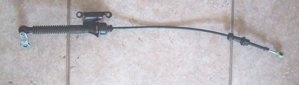

Z48LT-1 Posted April 1, 2007 Share Posted April 1, 2007 Hopelessly, I'm guessing your camaro shifter didn't come with the shifter cable. Here's what it looks like: The bracket bolts to a pair of pan bolts, the fitting on the end bolts to the shifter arm of the tranny, and the nylon fitting snaps onto a ball at the end of a lever inside the Camaro linkage unit. Hope this helps -- Gary BTW the fitting that bolts to the shifter arm coming out of the tranny appears to be permanently attached to the cable. Make sure it's included when you buy a cable. Quote Link to comment Share on other sites More sharing options...
Hopelessly Confused Posted April 2, 2007 Author Share Posted April 2, 2007 Actually my shifter came with a cable, but I didnt get the attachements that hook onto the tranny. So I had to make my own. Heres some pics. Quote Link to comment Share on other sites More sharing options...
Z48LT-1 Posted April 2, 2007 Share Posted April 2, 2007 Hopelessly, Nice job of backyard engineering, and I say that sincerely. Did the cable length work out for you? I worry that my shifter may need a shorter cable to get the stick in a decent location, but of course my hybrid ('48 Chevy/LT1/4L60E) is a different breed from yours. Cheers -- Gary Quote Link to comment Share on other sites More sharing options...
Hopelessly Confused Posted April 2, 2007 Author Share Posted April 2, 2007 Yeah, the cable is probaly a bit long but I got the shifter to fit in the orignal hole which worked out pretty well. Quote Link to comment Share on other sites More sharing options...
