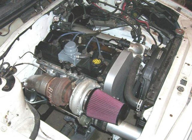

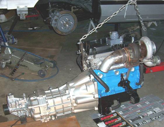

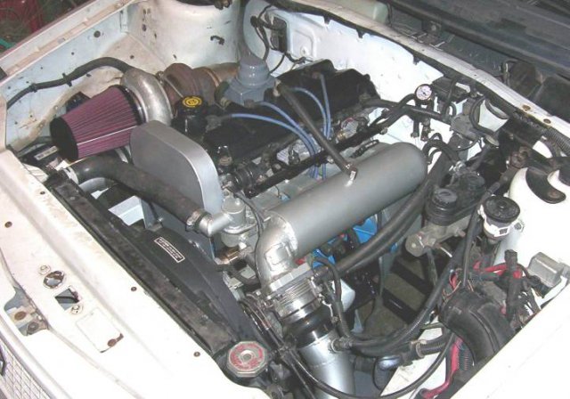

Greg55_99 Posted April 11, 2007 Share Posted April 11, 2007 This is proof that with the right junkyard parts... you can put together a pretty good (and inexpensive) drivetrain. Mopar 2.5L block Neon DOHC head 94-95 Dodge Dakota 2.5L bellhousing 87-92 Supra Turbo R154 5-speed http://www.turbododge.com/forums/showthread.php?t=130944 Greg Quote Link to comment Share on other sites More sharing options...

Pete84 Posted April 12, 2007 Share Posted April 12, 2007 Is that Mopar 2.5L block something sepcial or is it just a pull? Quote Link to comment Share on other sites More sharing options...
Greg55_99 Posted April 12, 2007 Author Share Posted April 12, 2007 Is that Mopar 2.5L block something sepcial or is it just a pull? Stock block modified to take the Neon 2.0/2.4L DOHC head. Junkyard parts. R154's can go for around $200. I've picked up a couple for $150 that were good. Greg Quote Link to comment Share on other sites More sharing options...
