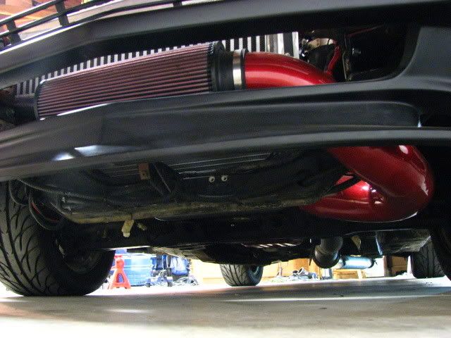

Guest 280ZForce Posted February 25, 2008 Share Posted February 25, 2008 Are You using exhaust tubing? And what is the make of your air filter? I like your design! Yes, using 4" exhaust tubing. Air filter is from K&N. I shouldve posted up some of the final intake pics... Quote Link to comment Share on other sites More sharing options...
jeffp Posted February 25, 2008 Share Posted February 25, 2008 I also did the 4" inlet pipe because of my turbo and MAF. I made the pipe in two pieces and used a silicone coupler to install them together. The really cool thing is that after I get my intercooler pipes removed the intake is easy to remove. I remove the aircleaner and 90 degree bend. Then the part that is cool is that I can remove the pipe to the turbo without removing anything from the car. I get it past the A/C lines, the headlight washer bottle and it just fits in the car slick as snot LOL. K&N makes the same filter you have, I got the K&N part and at the time was really glad it was available. Now a good powder coat job will make it perfect, and you wont have to worry about any rust. I just love this stuff LOL Quote Link to comment Share on other sites More sharing options...
Overkill Z Posted February 25, 2008 Share Posted February 25, 2008 im still so happy you got it back on the ground..make sure you dont bottem out on that intake pipe lol Quote Link to comment Share on other sites More sharing options...
Overkill Z Posted February 25, 2008 Share Posted February 25, 2008 ps the front wheel doesnt hit it!? Quote Link to comment Share on other sites More sharing options...
Guest 280ZForce Posted February 25, 2008 Share Posted February 25, 2008 ps the front wheel doesnt hit it!? Nope front wheels doesnt hit it even w/ 275s on 17x9.5s in front, but I do have to trim some of my airdam. Quote Link to comment Share on other sites More sharing options...
