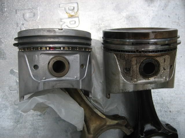

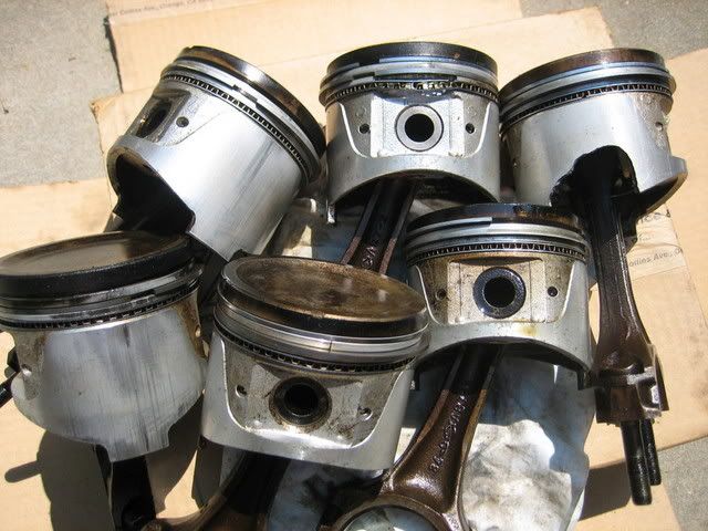

nienberg.11 Posted May 28, 2007 Share Posted May 28, 2007 I'd like to see some pics of the ring lands once the pistons are out. Quote Link to comment Share on other sites More sharing options...

gearheadstik Posted June 16, 2007 Share Posted June 16, 2007 nienberg.11 said: I'd like to see some pics of the ring lands once the pistons are out. I did this on the way back for SEZ about 20min away from the house. A pretty girl got beside me and was stairing and I could'nt help but kick it...We had just got the megasquirt and turbo installed the night before the race, it drove like a dream there as we tuned for the three hour drive...only one or two problems. As we drove the boost went to 6psi and I was happy...drove and tuned some more then it went to 10psi...So I was thinkin, "Dang the better we tune, the better it runs and builds more boost"...I was wrong...next it went to 15, then we hit 20,...I started thinking, I bet my custom wastegate actuator is too close to the exhaust and its melting a hole in it making it harder to open....Ding Ding Ding...We showed up at the race and spoke with Olie05 and Thumper about the tune and learned some new tricks... On the way home I just had to let off when boost was going to high... I was nearly shating my pants on how much power the old NA motor was making. Then comes trouble on a Pontiac Soltice... Kicked it and think the boost went to 25 plus as I checked the rearview for the girls and all I saw was a smoke cloud... Here was the head gasket..which looking at the tops of the pistons, I thought they were un hurt, so I put in my ARP studs and a metal head gasket to do it some more...Boy, what a waste of time. I fired it up and saw it acted like it was running on 3cyls and then did a compression test..120,60,50,50,50,20psi is what it read...So now I'm rebuilding it with a set if turbo pistons and refabing a new wastegate actuator so I can try it again...live and learn , I was and still am so happy with the power increase. Ever ringland was busted and the skirt was toasted on one...Here is the difference in ringland of turbo and NA pistons, if you have never compaired Quote Link to comment Share on other sites More sharing options...
