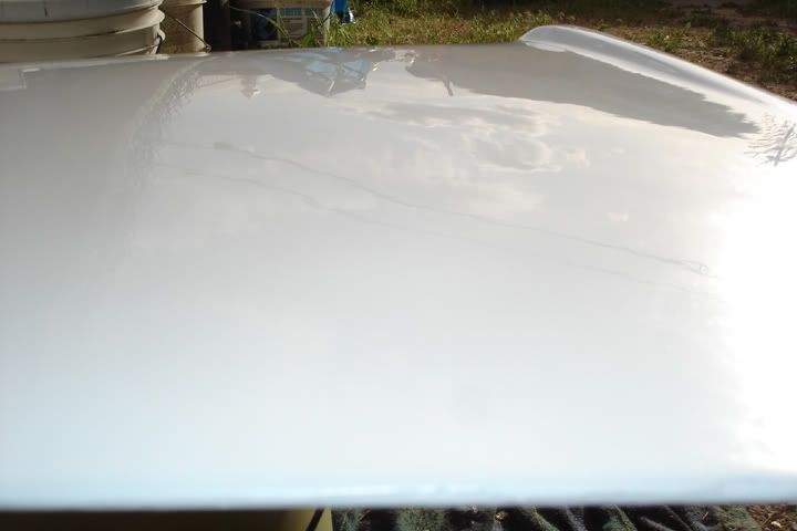

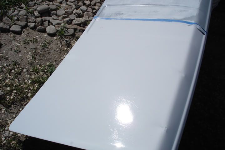

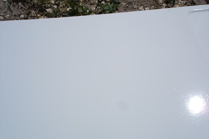

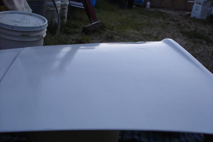

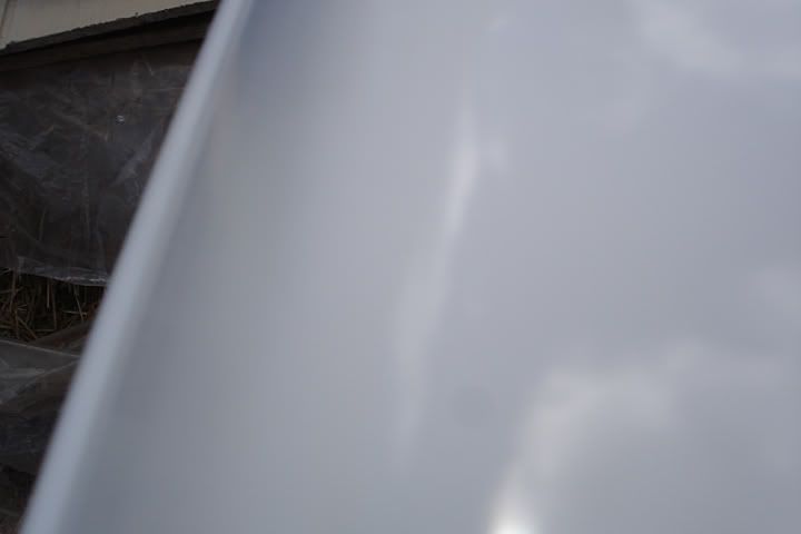

iknowwhoyou_r Posted June 23, 2008 Share Posted June 23, 2008 i know it's an old thread. just giving my inputs. i use: day one: day 2: day 3: day 4: day 5 and 6: hand buff once. imagine buffing it 3-4 times or with an electric buffer! i use this to buff in no details. anyone want to know detail, just ask. pics shows no justice. Quote Link to comment Share on other sites More sharing options...
tkach Posted June 23, 2008 Share Posted June 23, 2008 Any wet sanding? Quote Link to comment Share on other sites More sharing options...
iknowwhoyou_r Posted June 25, 2008 Share Posted June 25, 2008 Any wet sanding? yes wet sand after drying 2nd coat, fifth coat and last coat with fine grit Quote Link to comment Share on other sites More sharing options...
tkach Posted June 25, 2008 Share Posted June 25, 2008 May i ask what grits and btw great looking job ! Quote Link to comment Share on other sites More sharing options...
proxlamus© Posted June 25, 2008 Share Posted June 25, 2008 wow! that looks great! Quote Link to comment Share on other sites More sharing options...
iknowwhoyou_r Posted June 25, 2008 Share Posted June 25, 2008 May i ask what grits and btw great looking job ! can't remember exactly but it's the finer grits, probably 400 and up regular lowe's sandpaper. you should work your way up to 1000 grit. that was just a sample i did on an old datsun 510 trunk. thanks guys... i'm starting that paint job soon and will do a write up along with pics. Quote Link to comment Share on other sites More sharing options...

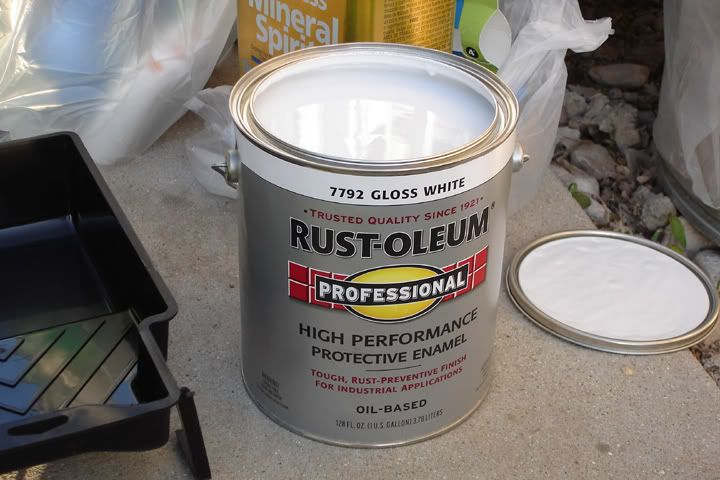

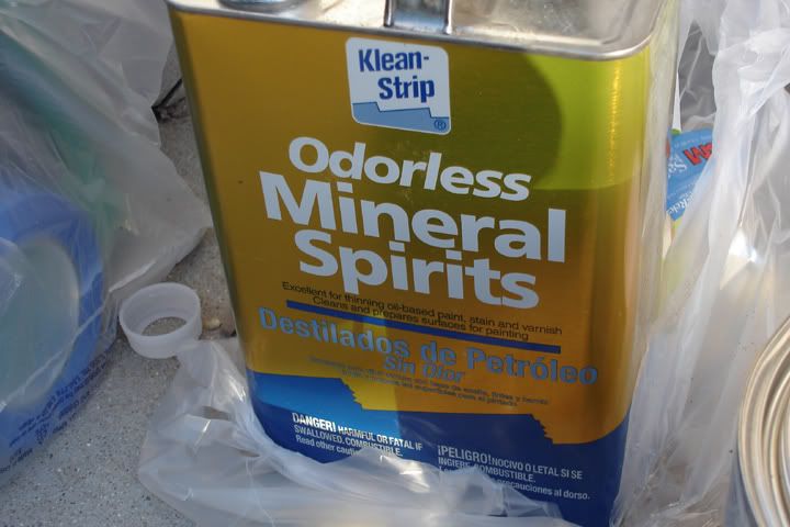

josh817 Posted June 30, 2008 Share Posted June 30, 2008 So... you just put it on bare metal? Does it not work well to go over some rattle can primer or rattle can paint? Only saying this because if you get the whole car down to bare metal you have to be fast, especially if you live in humid areas. Surface rust appears like within a week... Other than that my only questions are 1: the mineral spirits is to clean the surface or to thin the paint. Enamel may be a little rough for a spray gun...Lacquer thinner maybe? 2: Any sort of system for clear coats to protect it a little bit? Quote Link to comment Share on other sites More sharing options...
m4xwellmurd3r Posted June 30, 2008 Share Posted June 30, 2008 Mineral spirits is to thin the paint. you can thin the paint out enough to use it in a spray gun with excellent results too. For wetsanding, I'm a psycho and with things like this, I'd probably keep going PAST 1000 and go up to 2000 (I lap cpu IHS's, and go all the way up to COMPUTER PAPER as the final buffing/sanding) Quote Link to comment Share on other sites More sharing options...
iknowwhoyou_r Posted June 30, 2008 Share Posted June 30, 2008 So... you just put it on bare metal? Does it not work well to go over some rattle can primer or rattle can paint? Only saying this because if you get the whole car down to bare metal you have to be fast, especially if you live in humid areas. Surface rust appears like within a week... Other than that my only questions are1: the mineral spirits is to clean the surface or to thin the paint. Enamel may be a little rough for a spray gun...Lacquer thinner maybe? 2: Any sort of system for clear coats to protect it a little bit? RUSToleaum says it all... it's made for rust. this is just a cheap way for those short on budget or should i say "poor man's paint" yes, thin it out with mineral spirits to almost "water" liquid. it can go over anything.. even painted stuff. just keep adding (rolling) more paint (then let dry, of course) until you can't see whats under it. i've heard some use spray gun and gets good result, though i have not tried it. not sure about putting clear coat on it, but did heard you can do it. Quote Link to comment Share on other sites More sharing options...
