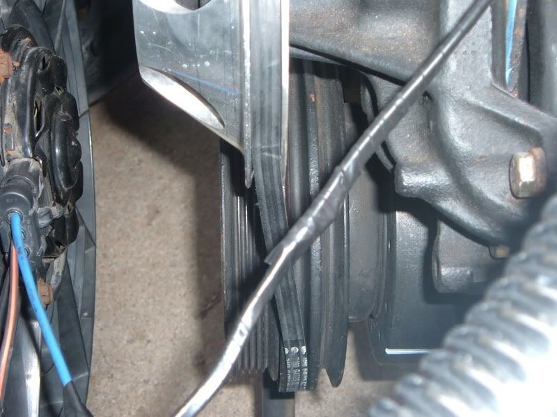

bschiltz Posted June 13, 2007 Share Posted June 13, 2007 Hey guys, I've got the ZX all back together and drove it for the first time with the V8 this weekend. The only problem is the pulleys for the alternator and the water pump don't line up with the crank pulley, i.e. the V-belt grooves on the crank pulley are ~1/4 inch too far rearward. This caused the belt to jump off (which I didn't notice) and overheat. So can I just shim the pulley with washers? I don't really want to shell out 95 bones to get a serpentine water pump and alternator pulley. Quote Link to comment Share on other sites More sharing options...
80LS1T Posted June 13, 2007 Share Posted June 13, 2007 Looks to me like you have a long nose water pump but need a short nose water pump. What kind of pulley is that on the water pump, looks aftermarket? If so does the belt fit with the stock pulley? Also did you piece this motor together or did you get as one assembley?(did the belt ever line up?). I wouldn't try shimming it. It might work but I dont think having the crank pulley on halfway would be safe, it might vibrate loose easier and fly off. Guy Quote Link to comment Share on other sites More sharing options...
bodie Posted June 13, 2007 Share Posted June 13, 2007 prob be easier to buy the crank pully that matches the water pump pulley Quote Link to comment Share on other sites More sharing options...
lbhsbZ Posted June 13, 2007 Share Posted June 13, 2007 Get the correct pulley, don't shim it. I can't tell which WP pulley that is from the picture, but if its for a Short water pump, get the long WP pulley. If that doesn't work, go pick up a new 2 groove crank pulley w/o the serp belt grooves. That should work if you have the correct WP pulley for the WP. Quote Link to comment Share on other sites More sharing options...
bschiltz Posted June 13, 2007 Author Share Posted June 13, 2007 I bought the motor as a whole, but it didn't come with the WP pulley. The pulley I have on there now is the cheep summit one, like this http://store.summitracing.com/partdetail.asp?autofilter=1&part=SUM%2DG3963&N=700+115&autoview=sku Quote Link to comment Share on other sites More sharing options...
lbhsbZ Posted June 13, 2007 Share Posted June 13, 2007 There are 2 different available WP pulleys...one for the long WP like you linked to, and one for the short waterpump. If you ordered the exact pulley that you linked to, then you have the correct pulley for your waterpump, and need a 3 groove crank pulley. Quote Link to comment Share on other sites More sharing options...
bschiltz Posted June 14, 2007 Author Share Posted June 14, 2007 Yeah, I made sure to get the long WP pulley. The thing that confused me is the alternator and WP line up, so I guess I'll get a new crank pulley. Any suggestions? How about this? http://store.summitracing.com/partdetail.asp?sub=1&part=SUM%2DG3958&N=700+4294908216+115&rsview=sku Quote Link to comment Share on other sites More sharing options...
lbhsbZ Posted June 14, 2007 Share Posted June 14, 2007 That'll work Quote Link to comment Share on other sites More sharing options...
