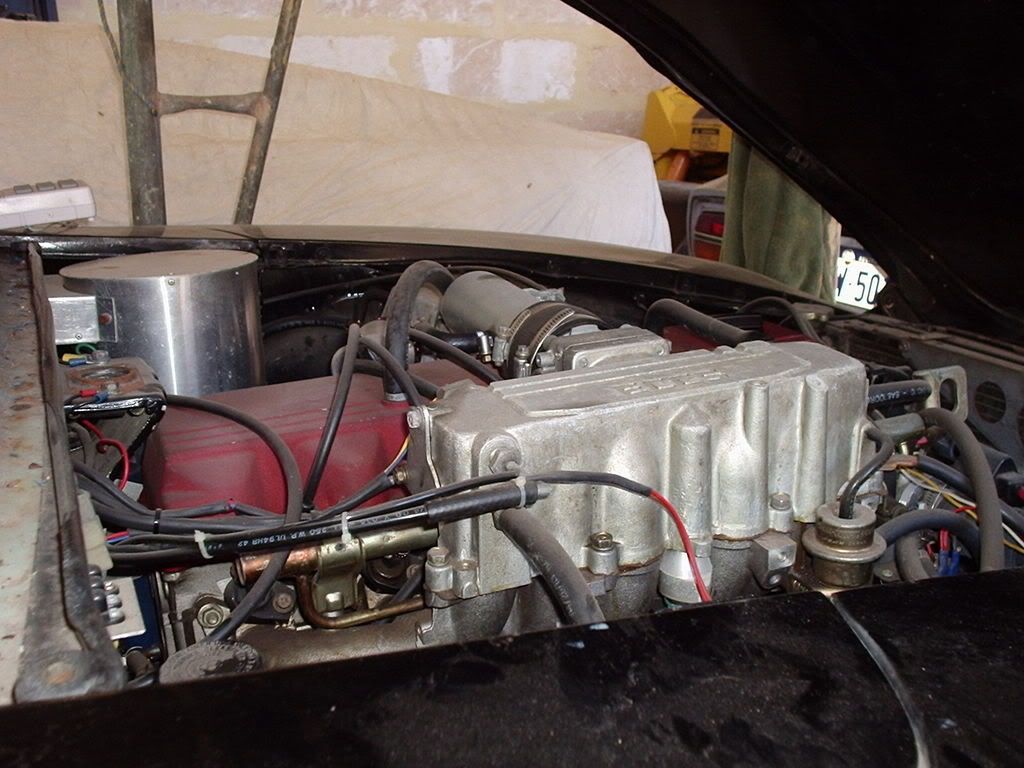

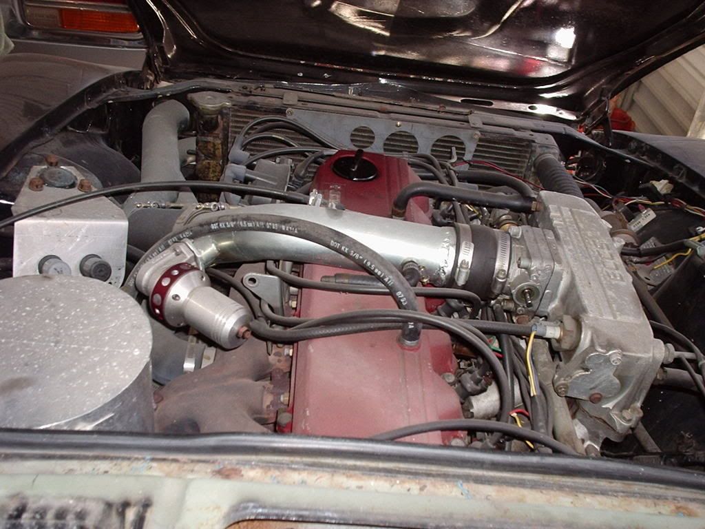

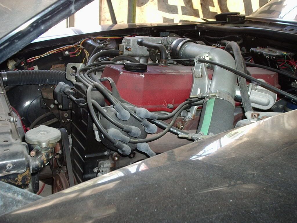

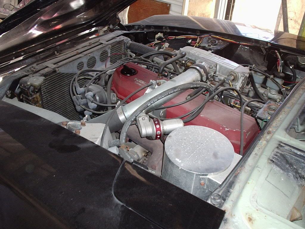

Z24O Posted July 8, 2007 Share Posted July 8, 2007 i've got a standard RB30ET in my 240Z,the mounts were custom made and are as low as you could get...so not sure about the CMRS ones the point with the least clearance is the front corner of the intake plenum which fouls the bonnet by about 5mm you may get away with canting the engine over by adjusting the mounts but i simply put a 10mm alloy spacer between the crossmember and the body effectively giving me 10mm more clearance,it worked well and i have not had any adverse effects(not that i expected any) i am about to put in a new (++hp) motor and switching to an auto so will take the spacers out as i have a custom plenum and extractor manifold i will be selling the complete turbo engine(T3 turbo and motor done less than 2000km since rebuild)/box/mandrel bent exhaust/radiator/tailshaft/intercooler/wiring loom/ecu(i used a wolf 3d and custom loom but have the std uncut VLT setup to go) i am sticking to the SOHC head,they are not prone to cracking if you have a recycling system to ensure the coolant water remains free of air bubbles/cavitation,they are cheap(just got a free one),plentiful,you dont need multi coils(unreliable),aftermarket cams are cheap and plentiful,bit of porting makes a world of difference,not quite as torquey as DOHC but SOHC has more than you can get to the pavement in a Z,cams for DOHC heads are outrageously expensive anyhow let me know if i can be of any further assistance regards paul Quote Link to comment Share on other sites More sharing options...
NickandM 72 240Z Posted July 8, 2007 Author Share Posted July 8, 2007 Thanks very much to all you guys, Paul you are the only person I can find that has actually kept the SOHC, I'm doing my car up for the missus and don't want her to kill herself so I'm keeping the engine pretty standard, as you said good porting and a nice cam and your set. Thanks for the pics too, was awsome to finally see what mine will look like, your idea with the spacer in the crossmember sounds like it will solve my problems if they arise and I think I mite make a flatter wider custom jobby anyway. Couldn't help but notice the holden rocker cover, hahah nice. Cheers. Nick Quote Link to comment Share on other sites More sharing options...
