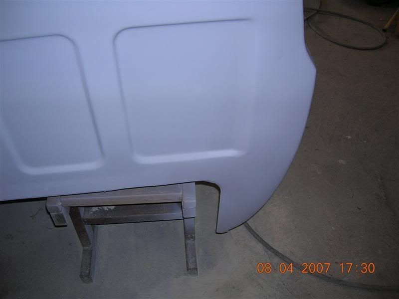

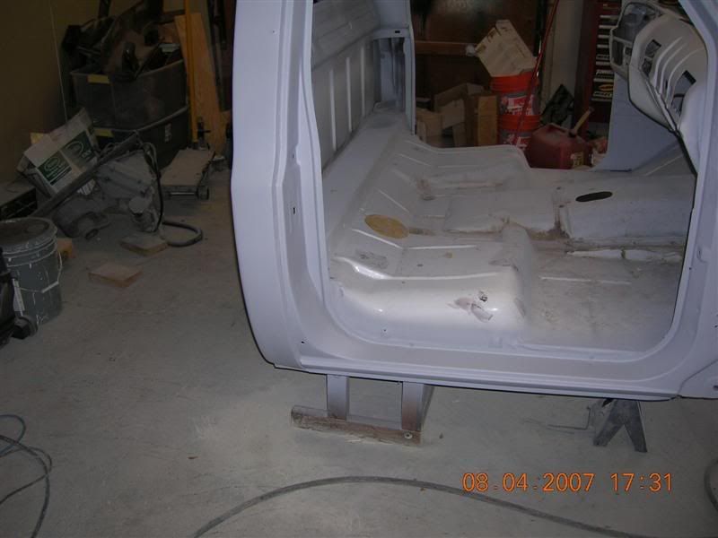

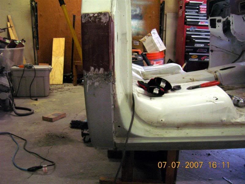

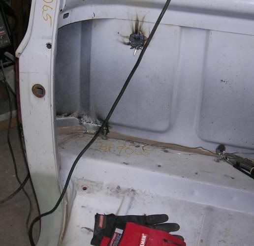

TravRMK Posted August 10, 2007 Share Posted August 10, 2007 Here are some pics of my old chevy I'm working on right now. Quote Link to comment Share on other sites More sharing options...

Some-Guy Posted August 10, 2007 Author Share Posted August 10, 2007 Looks good so far! I was basically taking and moving but just starting the tack was blowing holes in Iam trying to find some one with a mig that will let me borrow it! Quote Link to comment Share on other sites More sharing options...
