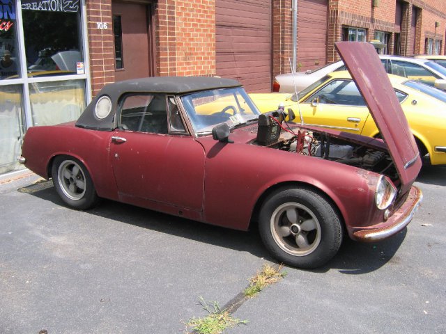

Revo's are the next most popular thing to Minilites in the Mini community. I got a set (of both) at a mini swap meet. Since they're so plentiful, a good set, even a good knockoff set from england aren't that pricey.
Now is that a 2000 or what? I'm doing a motor for a dude and parts are horribly expensive, I feel bad for the dude. Since we gave him a set price instead of hourly labor, I thought I might as well do the most I can while we wait for parts to come in. :mrgreen:
Don't rev the poor thing up too high. I was informed that like 6000-6500RPM is the highest you should go before your bearings decide to take a dump. Everything on the bottom end is hideously heavy. Untouched rods were 912 grams. I finagled them down to 840g and I bet I could have gotten more if I touched the bottom of the big end however this motor is warrantied so I don't want to get too crazy... I did take off lots of material around where the bolt goes through the rod, as you can see. Comparison would be like... our stock 240 rods were 700 grams I think. I can't remember what I had mine to but those weren't really lightened.
Bearing that took a ****:
So, nice car! Baby it. You don't want to rebuild a U20. The pushrod 1600 was cheaper last time I checked.
EDIT: Not all the pictures loaded the first time. D: I love the wheels and I see its a 1600! Valve cover is different too.
