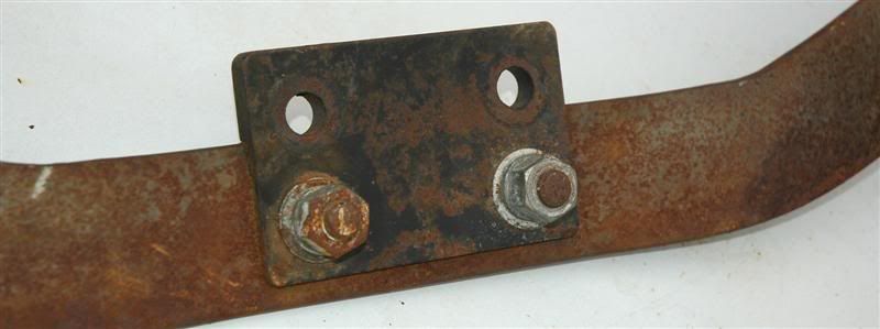

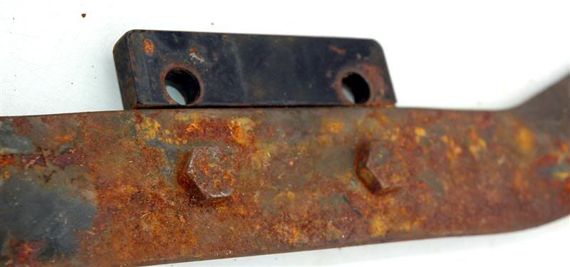

Administrators BRAAP Posted October 9, 2007 Administrators Share Posted October 9, 2007 I realize this has been done and will continue to be done, but I wanted to throw in my $.02 as I see drilling ANY holes in the mustache bar of a high powered Z car a bad idea. I redrilled my R-200 mustache bar for my V-8 280-Z when I raised the mounting position of the R-200 in my car, and on the test drive, only a mere few miles from the house, “lightly” playing, the mustache bar broke in half through the original diff holes, thus dropping the back of the diff. I was able to limp it back home with the half shafts rubbing on the control arms. I then built an adapter that bolted to the mustache bar utilizing the original holes using a steel plate for the diff to attach to. Never had an issue after that with over 15,000 abusive miles including 4th gear stomp and dump burnouts with the Lincoln Locker R-200. Pictured below is that abused mustache bar and adaptor after it has been sitting in the spare tire well of a parts car for a few years, hence the rust. It used to look nice, grey and black. Moral of the story… Drilling the mustache bar substantially weakens it and if you are installing an R-230 for its strength qualities, you really should have a new mustache bar or rear plate built, or at least an adapter that bolts to the mustache bar that doesn’t require drilling the mustache bar. A drilled R-200 Mustache bar WILL break before an R-180 would bust, let alone the R-230 or even the bullet proof long nose R-200, i.e., the R-230 is doing you know good if the mustache bar wont hold. Here is a picture I just took of that adaptor mustache bar and adaptor. Something similar could be built for the R-230 and using the poly mustache bar bushings, or a combination of the OE rubber and Poly mustache bar bushings, the mustache bar can be raised or lowered depending on how high/low you want the diff mounted in the car and how the bushings are trimmed, stacked, etc. Sorry, no pics of the original busted mustache bar. Quote Link to comment Share on other sites More sharing options...
Administrators BRAAP Posted October 9, 2007 Administrators Share Posted October 9, 2007 Edit.. Sorry fellas, I stand corrected. I just found where COZY Z COLE used the drilled method for his R-230 conversion and filled the old holes back in. My point is, if you drill, at least fill the old holes back in. Quote Link to comment Share on other sites More sharing options...
v8dats Posted October 10, 2007 Share Posted October 10, 2007 I realize this has been done and will continue to be done, but I wanted to throw in my $.02 as I see drilling ANY holes in the mustache bar of a high powered Z car a bad idea. I redrilled my R-200 mustache bar for my V-8 280-Z when I raised the mounting position of the R-200 in my car, and on the test drive, only a mere few miles from the house, “lightly†playing, the mustache bar broke in half through the original diff holes, thus dropping the back of the diff. I was able to limp it back home with the half shafts rubbing on the control arms. I then built an adapter that bolted to the mustache bar utilizing the original holes using a steel plate for the diff to attach to. Never had an issue after that with over 15,000 abusive miles including 4th gear stomp and dump burnouts with the Lincoln Locker R-200. Pictured below is that abused mustache bar and adaptor after it has been sitting in the spare tire well of a parts car for a few years, hence the rust. It used to look nice, grey and black. Moral of the story… Drilling the mustache bar substantially weakens it and if you are installing an R-230 for its strength qualities, you really should have a new mustache bar or rear plate built, or at least an adapter that bolts to the mustache bar that doesn’t require drilling the mustache bar. A drilled R-200 Mustache bar WILL break before an R-180 would bust, let alone the R-230 or even the bullet proof long nose R-200, i.e., the R-230 is doing you know good if the mustache bar wont hold. Here is a picture I just took of that adaptor mustache bar and adaptor. Something similar could be built for the R-230 and using the poly mustache bar bushings, or a combination of the OE rubber and Poly mustache bar bushings, the mustache bar can be raised or lowered depending on how high/low you want the diff mounted in the car and how the bushings are trimmed, stacked, etc. Sorry, no pics of the original busted mustache bar. that is a great idea! that can also take care of the spacer that is needed for the r230. Quote Link to comment Share on other sites More sharing options...
