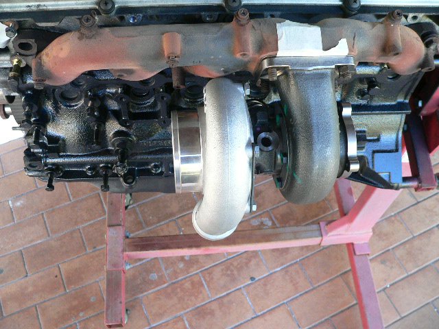

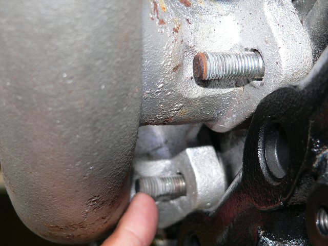

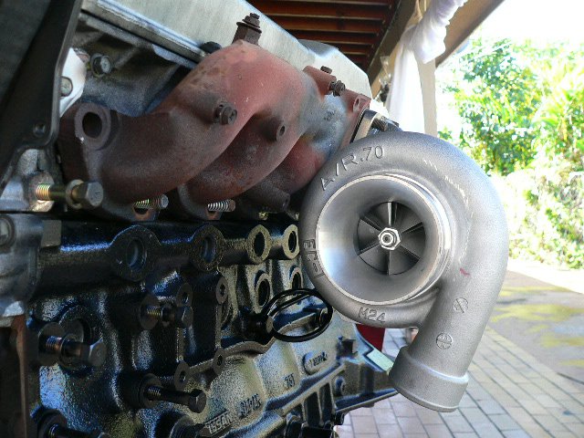

abes Posted January 8, 2008 Share Posted January 8, 2008 Any of you guys had any experience with the manifold on a n rb25det? I've read that a few of you have had issues with the steering shaft hitting the turbo in the Z's. I'm putting it in an '83 zx so hopefully It'll clear it. Last night I was mocking up the motor on the engine stand and I noticed when I tried bolting up the exh. manifold the studs were too long for the bottom section of the runners..... Do I need to remove the studs and replace them with bolts?? Those things are a pain in the a$$ to get to, and thats on an engine stand..I can't imagine having to remove or install that manifold while the engine is in the car. So far everything that has to do with manifold has been going against my keeping it simple theory 1) I still don't know if it is going to fit in the car once i get it bolted on. 2) I have to weld a t3 flange for my gt35r. The manifold is t4 flanged. Thats what happens when you get exited, you think your getting a good deal and tend to put little thing aside. 3) I found a hairline crack on the bottom o one of the runners after having it for about 6 months. 4) It's a lot heavier than I thought. Do guys think it's worth it??? I still have my stock manifold, which I really don't want to use. There's something about the turbo/ manifold that just doesn't look right and I'd like to get as much as I can out of my turbo. I'm stuck, Any ideas???????? Quote Link to comment Share on other sites More sharing options...

Noddle Posted January 8, 2008 Share Posted January 8, 2008 Last night I was mocking up the motor on the engine stand and I noticed when I tried bolting up the exh. manifold the studs were too long for the bottom section of the runners..... Do I need to remove the studs and replace them with bolts?? Have you thought about cutting the stud, so the its just long enough to hold the nut and washer ? Nigel Quote Link to comment Share on other sites More sharing options...
ZT-R Posted January 9, 2008 Share Posted January 9, 2008 dont slide the manifold all the way back onto the head. barley put it on the stud and start that bolt first... tightening it down will bring the manifold toward the head and the nut will end up down on the shaft... lol that sounds funny cast is weldable but expensive...... and not many people know now to do it correctly. Quote Link to comment Share on other sites More sharing options...
Careless Posted January 13, 2008 Share Posted January 13, 2008 dont slide the manifold all the way back onto the head. barley put it on the stud and start that bolt first... tightening it down will bring the manifold toward the head and the nut will end up down on the shaft... lol that sounds funny cast is weldable but expensive...... and not many people know now to do it correctly. I was going to suggest a combo of what both you and nigel suggested, but then I noticed that the manifold actually looks like there's not enough room on the side of the stud for a nut there, or even a washer.. almost as if it's been casted slightly askew. Quote Link to comment Share on other sites More sharing options...
