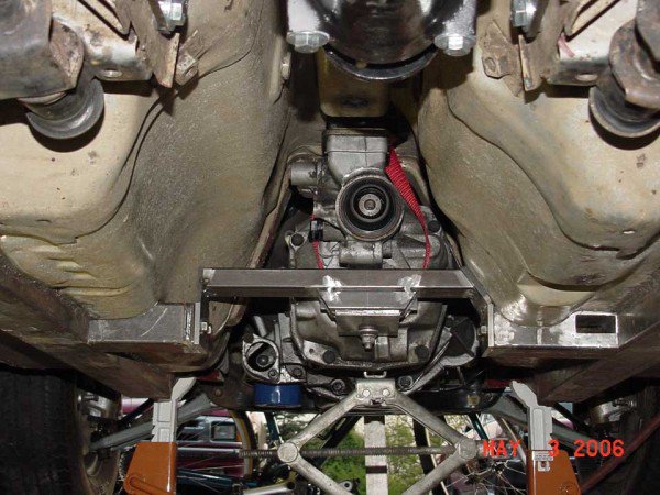

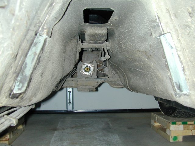

gvincent Posted January 26, 2008 Share Posted January 26, 2008 If you do a search there are lots of mounting options for the T56. I didn't like the JTR one as it seemed wimpy to me but lots of people have used it with no problem. I had a friend of mine make one of the mounts another member here made and was nice enough to supply drawings. I attached the drawing and a pic of the mount the member installed. I have pics at home of my mount but not here at work. I also show a picture of what I removed from the tunnel to fit the T56, it is tight on the passenger side and I trimmed off the ears on the T56 around the back-up light sender and had to dimple the tunnel a little up top in the area of the trans tunnel on the passenger side just about where the trans bolts to the engine block. The shifter sits perfectly in the shifter hole. If I find more pics I will post them soon but some are already in my gallery Thanks, Greg 280Z_T56_XMEMBER.pdf Quote Link to comment Share on other sites More sharing options...
