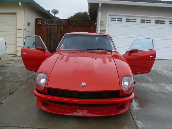

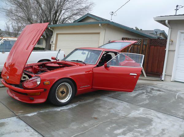

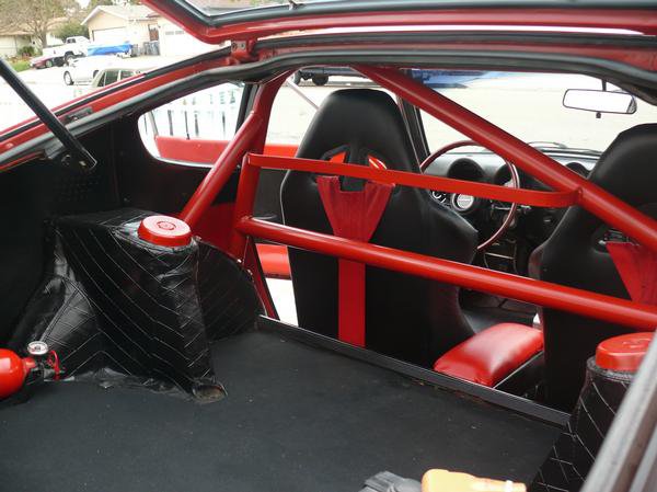

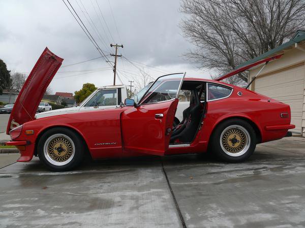

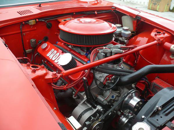

lilredZ Posted January 22, 2008 Share Posted January 22, 2008 Well I finally got the new Dart block in. I could do a significant write-up just on this past weekend but I'll give the skinny version for now. The block was a steal from e-bay. I lucked out and found a guy selling his brand new forged short-block kit...Dart block, Ross Pistons, scat crank and rods wtc...for a .155 over bore 369. I used my top end, flat tappet cam brodix heads, g williams 820 cfm carb and vic jr intake and strapped it in. I also did some interior work... it ran 11.8 /119 1/4 mi with the old 337 with about 435-475 HP (guess) I hope to be in the 11.0-11.5 range now. oh yea i installed the tokiko suspension also... i am too tired to write it all up now but may do it in the future. the weather is supposed to be terrible here in N. Calif (SF Bay Area) over the next 2 weeks and I'm a fair weather driver...oh well... by the way, if anyone knows where the heater hose is supposed to come through the firewall i'd appreciate your input here are some pics shot today: Quote Link to comment Share on other sites More sharing options...

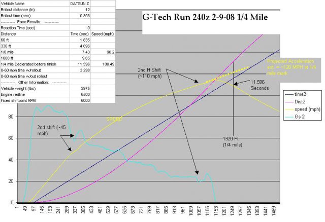

lilredZ Posted February 12, 2008 Author Share Posted February 12, 2008 Well...the carb isn't tuned correctly, the headers are too small but she's pretty fast. I hooked up my buddy's g-tech pro and went and ran some laps near the airport last weekend... The trick was learning not to pre-load...for my car I can't rev the motor with my foot on the brake (stall rev) at all. If I do all she does is spin the tires...spin...spin...spin. However if I just step on the gas and let off the brake at the same time she launches with minimal (if any) tire squeel and gave me a best run of 11.595. The 11.595 was at 108 MPH (which doesn't add up) so I pulled the data and found my problem: The G-Tech doesn't rely on position at all so I was guessing where th 1/4 mile mark was. I overshot the mark and then had to brake pretty hard to stay safe etc...aparently I was not going far enough. The good news is that even with the obvious decelleration at the end I still ran solid 11.6s to 11.8s all day long. Once I learned how to launch, it was easy as pie...until I broke a u-joint in the drive shaft. I had to nurse it home. Here is a video of a few launches (link) you can see run or 2 with tire squeel and most without...then a little showing off: http://my.break.com/content/view.aspx?ContentID=450381 lilredz Quote Link to comment Share on other sites More sharing options...
