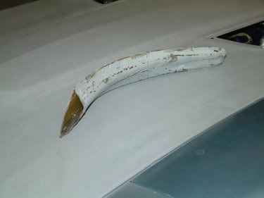

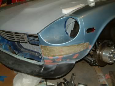

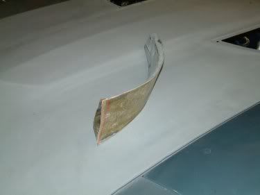

datsun40146 Posted January 27, 2008 Author Share Posted January 27, 2008 I found this http://forums.hybridz.org/showthread.php?t=103873 Look at the pic that Zhadman posted. This is more or less what I was thinking I would do. With the exception of milling the bumpers down thinner so they hug the body more. What do you guys think of them? Quote Link to comment Share on other sites More sharing options...
datsun40146 Posted January 27, 2008 Author Share Posted January 27, 2008 Thanks to everyone who posted these pictures in anotehr thread, I put them in one place so I can find them later. Thanks hybridz! Quote Link to comment Share on other sites More sharing options...
MJLamberson Posted January 27, 2008 Share Posted January 27, 2008 those last few pics, whoever made that should make more and start selling them, those are great Quote Link to comment Share on other sites More sharing options...
datsun40146 Posted January 27, 2008 Author Share Posted January 27, 2008 That would be jbc3 he made those, I've already PM'd him about them. I'll post here what I learn from him. Quote Link to comment Share on other sites More sharing options...
datsun40146 Posted January 27, 2008 Author Share Posted January 27, 2008 Quoted from jbc3 in a PM he sent me. I actually finished the fiberglass inserts and didn't like them much. All you do is cover the insert holes and surrounding area with wide masking tape. Fiberglass the area and then when it cures, stretch a layer of glass to form the outer or final surface and glass it. The whole thing peels off when you are done. The problem I had with mine is I peeled it off too early and the whole thing twisted slightly making it hard to fit perfectly flat. I had a sheet of 1/8" Kydex (heat mold able plastic) so I cut a form out of thick paper, cut the kydex, heat molded it to the shape I wanted to cover the insert holes flush with the outer body and when it was done, I used 3M double sided adhesive to hook the covers on Quote Link to comment Share on other sites More sharing options...
