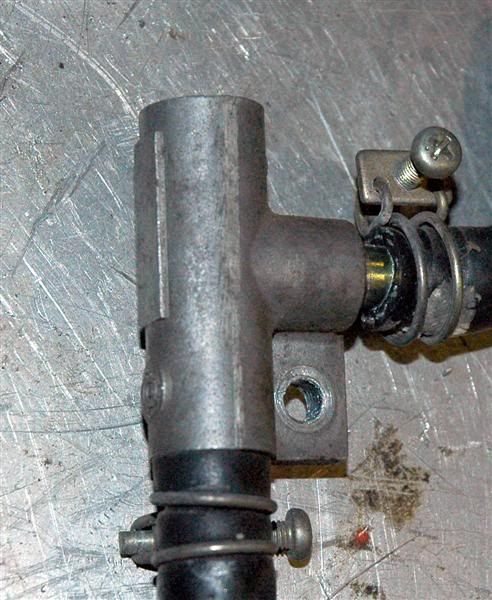

Administrators BRAAP Posted February 19, 2008 Administrators Share Posted February 19, 2008 I'd like to do a throttle body upgrade simply so I can adjust the idle with an idle bypass screw rather than having to mess with the stock 280ZXT throttle stop. I've removed the AAC, VCV, EGR, etc so now I need to actually adjust my idle and that would make it a little easier. Later '81-'83 N/A 280-ZX's came from the factory with a remote mounted idle bypass screw, attached to the side of the plenum, allowing idle speed adjustment by altering the air bypassing the throttle plate, i.e. no need to adjust throttle stop. I thought the Turbo cars did as well? I didn't know the 240-SX throttle body even had the idle bypass built in? Do you have a picture of that? In short, swapping to a 240-SX throttle body just to acquire idle speed control really doesn't make sense. Quote Link to comment Share on other sites More sharing options...
DuoWing Posted February 20, 2008 Share Posted February 20, 2008 I could be wrong on the 240sx throttle body, although I believe the Z31 might work, but you'd still need the spacer. The turbos never had an idle adjustment screw on the throttle body. I guess Nissan figured the newer ECCS, VCM, and AAC would be good enough to not need to adjust the idle? When they got to the Z31 they must have realized that sometimes it doesn't always work as it's supposed to and gave the idle adjustment screw back. Quote Link to comment Share on other sites More sharing options...
Administrators BRAAP Posted February 20, 2008 Administrators Share Posted February 20, 2008 The 240-SX throttle body, as far as I am aware, has no integral idle speed adjustment, same as the late ZX and ZX-T throttle body, like what you currently have, which means you’d still be in the same exact situation that you are in now, having to adjust idle speed using the throttle stop. The Z-31 throttle body does NOT have integral idle air bypass either. Now the early 280-Z, (’75 through at least ’78, possibly through early ’81, though I can’t confirm that), DID have an integral idle air bypass, (I’ve got early 280-Z, late 280-ZX and Z-31 throttle bodies here). The N/A 280-ZX from ’81 on, (possibly earlier), utilized an external adjustable idle air bypass, functions just like the early 280-Z integral style, but is external/remote, not integral with the throttle body itself, (see pics below). Due to the fact that you eliminated a lot the ZX-T intake manifold stuff, it seems like it would just be easier to incorporate the N/A ZX idle air bypass or the early 280-Z throttle body, than to install a throttle body that doesn’t offer any more idle speed adjustment than the throttle body you are currently using. This remote idle speed adjuster is dirt cheap at the wrecking yard, easy to plumb, can be located ANY where on/in the car, (with enough vacuum hose, even inside the cockpit if you wish). Here is the N/A ZX idle speed controller as mounted in the car, on the side of the manifold itself. Here is one of those OFF the car. Here you can see the slotted adjuster, (flat blade screw driver to adjust idle speed via regulating air flow that bypass the throttle valve itself). Quote Link to comment Share on other sites More sharing options...
