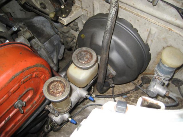

TrumpetRhapsody Posted July 21, 2008 Author Share Posted July 21, 2008 Thanks! Yeah I know a guy with a welder and drill press, so I should be set. The milling we might do by hand, we'll see. Forgot to mention: the brake booster was filled with old nasty brake fluid from the old leaky master cylinder, so I guess that explains the failure. Quote Link to comment Share on other sites More sharing options...
