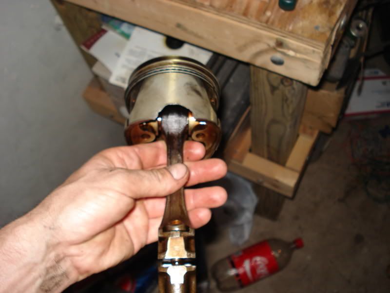

blueovalz Posted March 3, 2008 Share Posted March 3, 2008 I realize this doesn’t matter as the short lock needs to be torn down and rebuilt regardless, I just want point out what that scuffing really is, it is not your wrist pin. Thank you. The photo evidence was not matching the early explanation, but this explanation seems to have hit the mark. Quote Link to comment Share on other sites More sharing options...

Tony D Posted March 4, 2008 Share Posted March 4, 2008 Yes, with cooler (read sober) heads prevailing, BRAAP is correct, the pattern is different than what was in ours. It does look like a broken ring land. Looking at it again, it looks too far 'to one side' to be the piston pin anyway. BRAAP is right, the 'double score' is what we had. Not a polishing like you have. But then again....going on my second Big Gulp of Captian Morgan & Diet Coke may have had some bearing on my exuberance that evening... Come to think of it, I still have some DC in the Big Gulp out in the truck, I better go get it before the ice waters it down too much and get a-mixing. JeffP sunk the rings and lands on Five of Six cylinders at 8.39 psi of boost. Boost really is irrelevant, you run lean and detonate, things will break, some sooner than later. As for what caused the interference to walk.... I'm thinking something like 60+ miles running at 8500rpm+ in 1.5 and 5 mile bursts... It was up to 8400 by the end of the first mile at Bonneville, and then gained 500 rpm each mile subsequently... That might have had something to do with the small ends 'moving around a bit' and loosing grip on the pins and letting them walk to the walls. Quote Link to comment Share on other sites More sharing options...
jeffer949 Posted March 4, 2008 Author Share Posted March 4, 2008 well i took the motor out this afternoon and took that piston out here is what i found so who has an extra turbo piston laying around they wanna mail me??? Quote Link to comment Share on other sites More sharing options...
HowlerMonkey Posted March 4, 2008 Share Posted March 4, 2008 I've got 4 ok turbo dished pistons out of an engine I recently bought from the classifieds but they were on a car with a 20G turbo with blocked wastegate which is probably what caused #5 to break a ring land. That said, I might not trust the rod bolts on the assembly if I do mail one. I'll try to remember to bring them in tomorrow. Quote Link to comment Share on other sites More sharing options...
