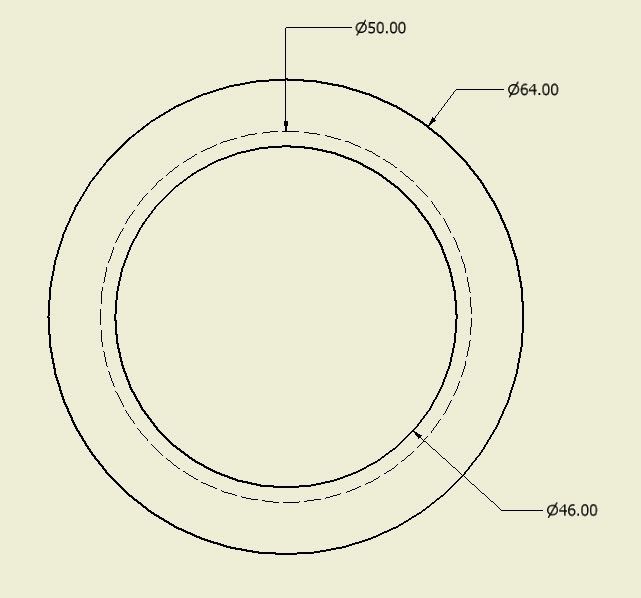

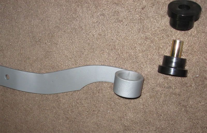

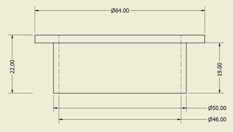

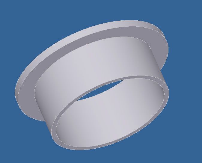

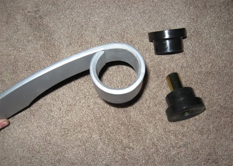

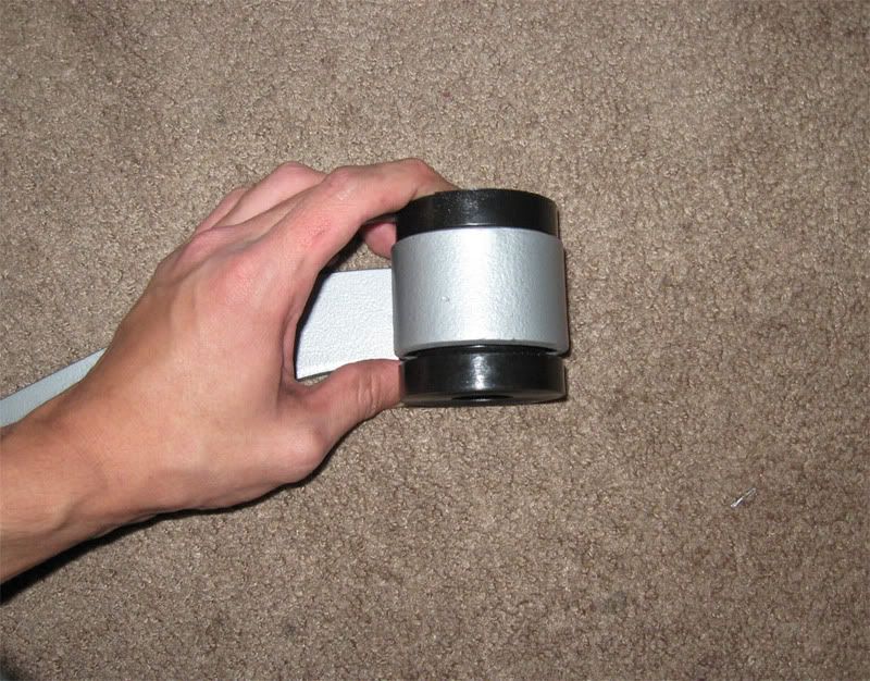

Oops. I think I did something bad. I had the bushings pressed out by the local machine shop thinking I was slick. Well... I took a look at the replacement bushings... then the hole I had. Well appears that I had them remove the metal outside bit which apparently doesn't seem like it should be removed... View photos below. I have play in the up down and wiggle around (axis) directions. So should I just have a sleeve made to the specifications (also below) or does someone else have a better idea? Or even better yet, is there an available replacement? Thanks guys!
Ya you messed up. i would get some tubing that was the proper size and just press it in. i dont think you would need the top and bottom lips
I think I need the lips since the bushings touch each other w/o the lips... I could probably just machine the bushings down though.

I have a machine shop here at school, but I am trying to think how I am going to bore out the center to 46mm from the available tube sizes I see on McMaster.
Funny! I just dealt with this last week. The bar I just put in my car came out of another Z and had poly bushings and was missing the sleeves. I went down to the exhaust shop and got a small section of 2" pipe. I then cut 2 sections at 1.5" long and cut a split long ways down the pipe. I then just tapped it in with a hammer, slid the new poly bushings in and good as new. :)
So if I am understanding this correctly Savage... you took 2" exhaust tubing, cut a slit up it vertically and let it get crushed by the mustache bar, then put the bushings in... Did it eliminate slop? What did you do to make the up/down direction tight - bend it with a hammer over the top? Thanks!
Correct. It was still a tight fit, as I had to hammer it in place. It's not going to move and with everything bolted in place, it couldn't move, anyway. The sleeve was really tight fit and the bushings had absolutely no slop and had to push it into the new sleeve. It worked out perfectly. Hope that helps.
