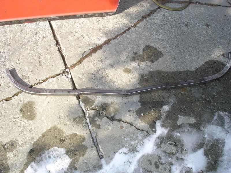

AK-Z Posted April 18, 2008 Share Posted April 18, 2008 Need to do some more trimming Quote Link to comment Share on other sites More sharing options...
Roostmonkey Posted April 19, 2008 Share Posted April 19, 2008 Nice job, I like the shape.Is it a channel or a tube? What do you plan for a finish? Quote Link to comment Share on other sites More sharing options...
AK-Z Posted April 19, 2008 Author Share Posted April 19, 2008 Roostmonkey said: Nice job, I like the shape.Is it a channel or a tube? What do you plan for a finish? Thanks. 2" square from Home Depot. I cut slits and bent it, then tack welded it. I trimmed it but the curve is too sharp, so I'm going to cut more slits and bend it more outward. For finish. I think I'm just going to body fill it and shape its because I'm going to paint it black anyways. Shipping up here is stupid expensive, so I have to make most of my stuff. But some things I do buy regardless of shipping because of the debate of building difficulty to paying for the work. Body panels, I try to fab myself, just to try. That and because tabco is always back ordered when I call. Quote Link to comment Share on other sites More sharing options...
deja Posted April 19, 2008 Share Posted April 19, 2008 I like the shape too. Making your own stuff is always cooler than buying a pre-made one. A continuous curve would have been easier but not as unique. Post some picts when you get it done. Quote Link to comment Share on other sites More sharing options...

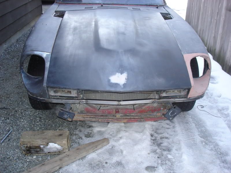

AK-Z Posted April 19, 2008 Author Share Posted April 19, 2008 deja said: I like the shape too. Making your own stuff is always cooler than buying a pre-made one. A continuous curve would have been easier but not as unique. Post some picts when you get it done. Thanks, and will do. Finally got to fit with the buckets, but with the hood on, its kinda hidden away under the hood.. I'm going to try to add some metal and have it sit further forward. I'll try to post a pics of what I'm talking about and what I end up with at the end of today. Quote Link to comment Share on other sites More sharing options...
AK-Z Posted April 21, 2008 Author Share Posted April 21, 2008 Sorry guys.Computer decided to take a crap on me. Well this is what I was talking about before. I'm going to hold off on rebuilding the bumper for now, so I can work on my "special project" on the car. I dare you to guess what it is . I'll be that you predict what I have in store . BTW I have a 280z door for sale. includes everything including striker and hinges. high ball price is $300 with glass. http://forums.hybridz.org/showthread.php?t=133110 Quote Link to comment Share on other sites More sharing options...
