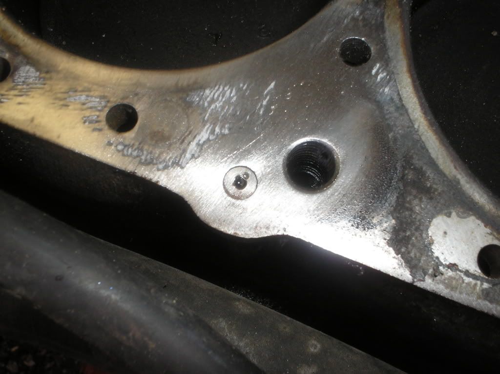

JMortensen Posted May 7, 2008 Share Posted May 7, 2008 Stock for the early cars was a solid cam with a spraybar. You can run an internally lubed cam with a spraybar. Stock for later cars (76 and on?) was internally lubed cam. You cannot run a solid cam with no spraybar. The spraybar gets fed from the cam towers, which get fed from the hole in the picture. There is a bit about opening up the hole in the How to Modify book, I would not recommend it as it will get you lower oil pressure it idle. Quote Link to comment Share on other sites More sharing options...
