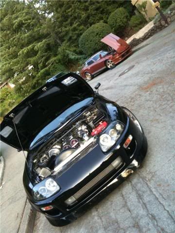

Overkill Z Posted September 30, 2009 Author Share Posted September 30, 2009 Yesterday i was able to barrow a friend of mines supra aem ems. Plugged it into my car..did not change anything...and it revved to over 3500 rpms then started limiting...so at this point im almost positive its just tuning!!!!!!!! Quote Link to comment Share on other sites More sharing options...
Overkill Z Posted September 30, 2009 Author Share Posted September 30, 2009 Quote Link to comment Share on other sites More sharing options...
