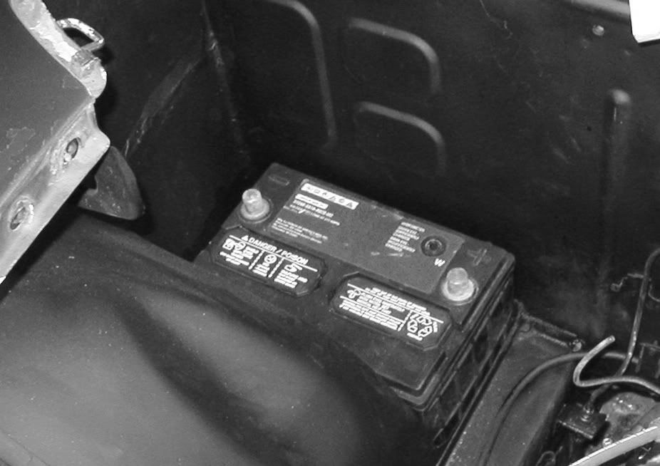

JustinOlson Posted June 20, 2008 Share Posted June 20, 2008 I will be relocating my battery very soon as I'm rewiring my car completely. I will be running my exhaust out the fender where the battery currently lives. I'm trying to decided if I would be best served moving the battery to the rear to help with weight over the rear end. This is a drag car and will be making a lot of power. Just trying to decided which route to go. Also, If I do just drop the baterry in the current location, will I have troubles with heat from the turbo and exhaust? The exhaust will be a short 90 degree 5" dump pipe. I'm trying to decided if I should just drop my battery like Ron Tyler has done here: Or relocate it to the back of the car like Z-gad has done here: Quote Link to comment Share on other sites More sharing options...
ShaggyZ Posted June 20, 2008 Share Posted June 20, 2008 Is the exhaust going to go over or under the battery if you use the battery spot like Ron's? I think with exhaust wrap and/or thermal coating and adequate heat shielding (I'd do a double layer setup) you'll be totally fine. In fact, you could probably just get away with the heat shielding as long as it covers well. There are plenty of cars out there (like my XR4Ti) which have the exhaust running pretty close to the battery. I wouldn't worry about it much. Still, I think putting the battery in back would be best. Quote Link to comment Share on other sites More sharing options...
JustinOlson Posted June 20, 2008 Author Share Posted June 20, 2008 My exhaust will exit like this setup. It would go over the battery and straight out the fender. My turbo will be over on the passenger side of the motor. I could add heat shield over the battery as well. Just kinda undecided about which route I want to take. Quote Link to comment Share on other sites More sharing options...
