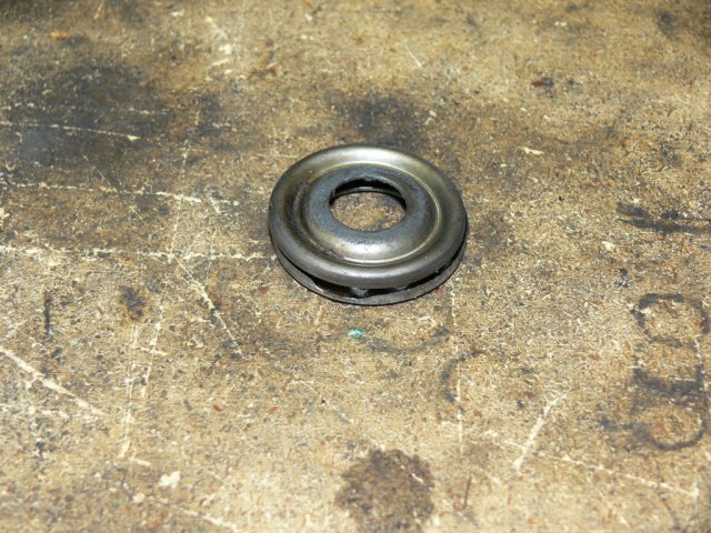

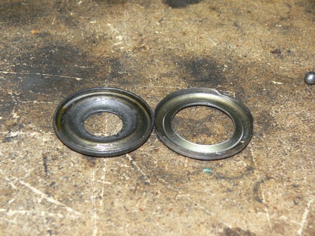

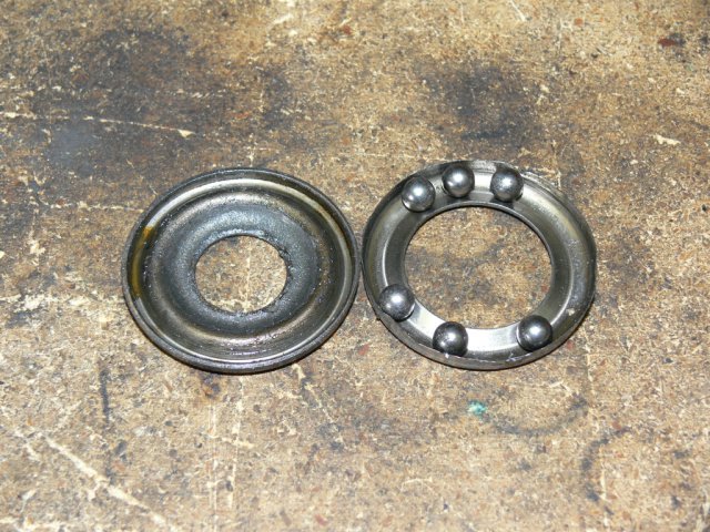

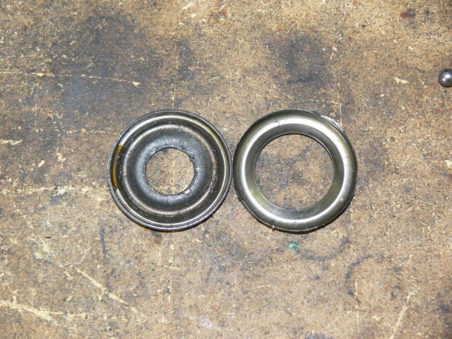

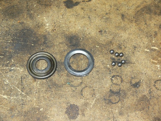

Just my luck, I found these parts when I pulled back into the garage just now and I have a track day tomorrow at 7 am. Actually, I noticed the ball bearings before I pulled out to leave and figured they were from my creaper which has lost bearings before. Turns out the creaper isn't missing any, and when I pulled back into the garage I ran over one of the races. I drove about 10 miles on the errand and didn't notice anything wrong. I've been under the car and can't find anything loose or amiss. I thought it might be from the top of the front struts, but after loosening it enough to pull it down a little, the diameter of the race looks to be larger. These are a little over 1.5" across. Also, how would these fall off without whatever went through the center hole preventing it from falling off the car?
Anyway, I'm not real happy about the idea of tracking the car without knowing where this came from and will probably miss the day if I can't figure it out. Any and all suggestion are welcome and encouraged!
I don't think I've seen anything like that on a Z car, but some possibilities might be after market camber plates or T/C rod kits.
I think you need to look at the creeper, rolling stool, floor jack, cherrypicker, etc. Unless you find it came off the car, I'd go to the track day and just let the first session be a cautious shakedown run.

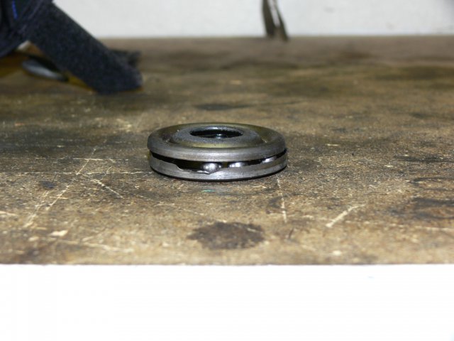

I put everything back together and on a local drive cannot find anything abnormal. FWIW, in this picture you can see on the bottom piece where the metal fatigued and that must be how this piece broke free. My wife was suggesting things like window crank mechanism, and while I don't think that's it, I think she's going in the right direction thinking about things that don't carry a lot of load. That bottom piece is very light metal and couldn't carry much load at all.

Have you jacked up the car and checked for any loose parts yet?
Like was mentioned earlier about a custom T&C set up. Other than that there's isn't anything that looks like that on a stock 240z that I am aware of and I had my suspension completely torn down for new bushings, springs, regrease front strut bearings etc.
Did a caster fall off the Jack? The races and the bearings look just like my 2.5 ton floor jack bearings and races.
Oops NM, looks like you checked the jack.
Kids weren't messing around in the garage at all? Wife maybe? Definitely doesn't look like from the Z.
Thanks for the suggestions. I did jack it up (both ends) and crawled around underneath. So far I can't see anything abnormal. Logic says that it's not from the car, but if you saw the color of the metal and the dirt/grease embedded, you'd think it was indeed from the car. And no one else spends time in that side of the garage except the Z and me. And I wish I had custom camber and/or TC parts, but I don't.
Like I said, I'm going to drive it and hopefully it's not anything critical.
It is a roller from your garage door. Check the joints and rollers along the tracks and I think you will find one missing.
