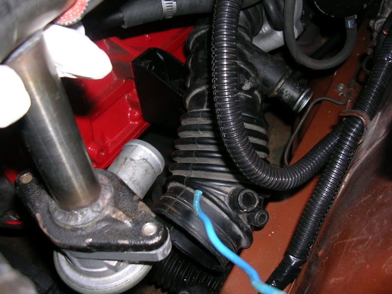

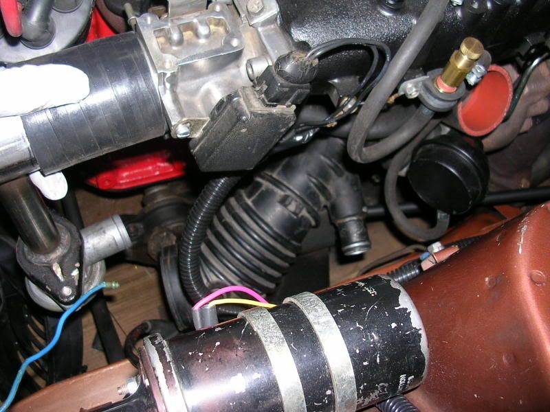

What are everyone's thoughts on crushed 1G DSM BOVs? Do they still work okay?
I'm having a hard time finding 1-1/4 hose for the BOV recirculation. I know that you're technically not supposed to vent to atmosphere with a MAF setup like mine, but running a big fat hose looks like a real pain even if I do find one.
