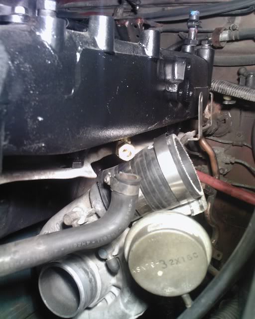

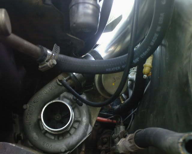

Plug the original PCV hole, and retap it --- the PCV pipe and hose shows you where pretty clearly. The N42 manifold has the PCV right where the turbo scroll goes, the Turbo Manifolds have it relocated to the place where your hose is showing it to be. Simply move it.
How big is that fitting? Do you expect it to support the PCV role? Where is the anti-reversion valve now?
Which vacuum hoses are you talking about, I addressed the one that was circled in red, as I thought that was the one you wanted information on...
The one with blue tape on it goes the to brake booster
The one in the center of the manifold down below the throttle linkage bar goes to the FPR Vacuum Reference Port.
The AAR valve goes to the J-Pipe off the turbo.
The one hanging there in the foreground used to go to the Carbon Cannister, but like someone just said 'what year car'---really vague request, some details would help. What are you looking for if not what you circled?

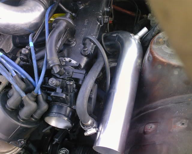

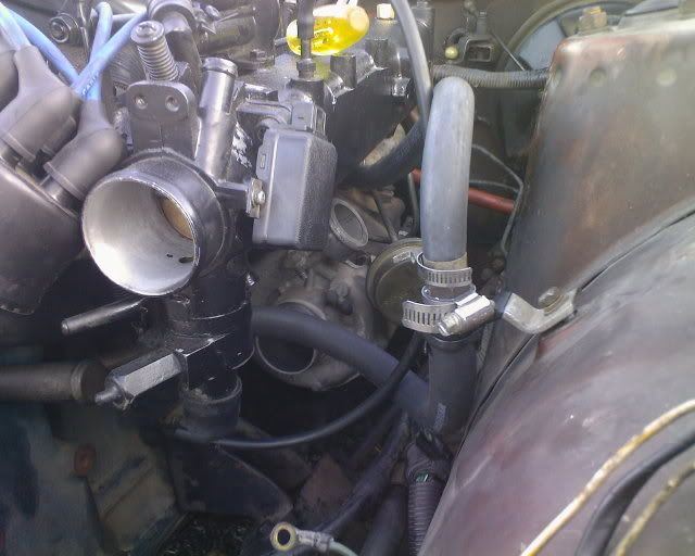

I got the PCV vacuum setup
and I hooked these together too, if this is what you meant, Tony
