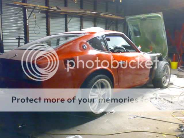

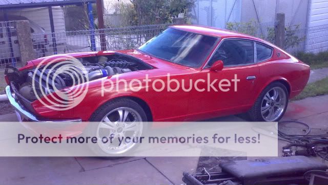

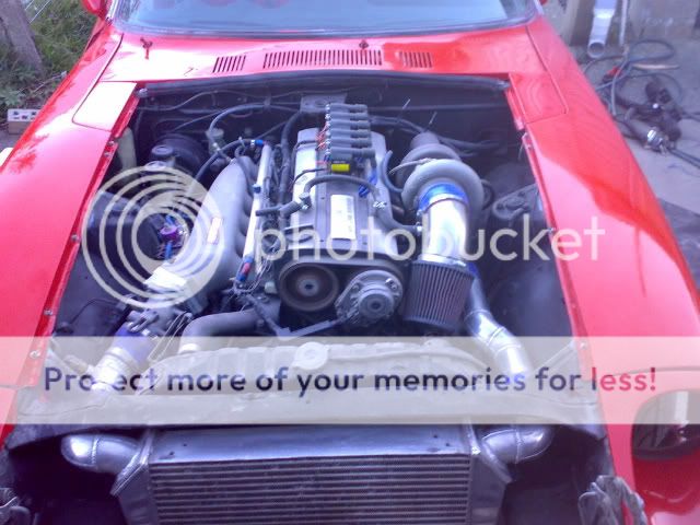

rbs30 Posted August 16, 2008 Share Posted August 16, 2008 Hey guys. After a solid week of work my rb30det z is almost done!! The engine and drivelinehave been done for quite a while but it looked like crap. I have finally finished painting it and it is almost back together. Cant wait to get back out there and start terrorising the streets again. Cant wait to hear that wastegate vent to atmosphere again. lol. Anyways, thought id just share a couple of progress pics. getting there no i didnt do the engine bay because im lazy and its not the worlds greatest paint job, i just wanted it to look decent. Quote Link to comment Share on other sites More sharing options...

DirtySouthZ Posted August 17, 2008 Share Posted August 17, 2008 What exhaust manifold are you using and what size turbo? Nice work. Quote Link to comment Share on other sites More sharing options...
rbs30 Posted August 17, 2008 Author Share Posted August 17, 2008 Thanks. The short engine by its self i dont think would have cost much as i did it all myself. The head rebuilt etc with the valves ground etc prob cost $1000 and the block with forgies, bearings etc prob $1500-1600 at a guess. Im in aus so rb30 stuff is fairly cheap. The turbo is a GT35R with a 1.06 exh a/r on a pre-made manifold from the parts shop but i am working on a new steam pipe one at the moment to bring the turbo forward and down. It has only been tuned to 15psi so far and at that it made 550 rwhp and the turbo is out of puff. Quote Link to comment Share on other sites More sharing options...

Z24O Posted September 1, 2008 Share Posted September 1, 2008 when do you start seeing boost with the 1.06 turbine housing? how close is the turbo to the bonnet(hood) anyone know if the 6Boost hi-mount exhaust manifolds give the GT35's enough clearance in the Z's?? Quote Link to comment Share on other sites More sharing options...
Bishopsrock Posted September 1, 2008 Share Posted September 1, 2008 Hi Luke, Your car looks great and i am particularly impressed by your intercooler pipework - work of art mate. Looking at your pics, it seems that you might be using the stock radiator? If you are, then I would consider replacing it with a modern dual pass one. A guy that I know has fried his RB26 after only 2 weeks on the road - apparently due to the stock radiator being unable to disperse the heat quick enough whilst on boost. I bet that your car will be amazing to drive though - does an RB30 qualify you to join NASA? Cheers Quote Link to comment Share on other sites More sharing options...

rbs30 Posted September 2, 2008 Author Share Posted September 2, 2008 when do you start seeing boost with the 1.06 turbine housing?how close is the turbo to the bonnet(hood) anyone know if the 6Boost hi-mount exhaust manifolds give the GT35's enough clearance in the Z's?? I see boost at 2500-2800 and full boost by 3400ish but that said, it doesnt take long for them revs to get there because before you hit boost it is still a 3ltr engine so it has the torque to get up onto boost fairly quicky. The turbo is sticking through the bonnet with that manifold and the 6boost manifold will do the same. On a rb30det in a zed you will need a custom manifold because they sit that bit higher than the rb's. Im in the process of making a steam pipe manifold to bring the turbo forward and down. Hi Luke, Your car looks great and i am particularly impressed by your intercooler pipework - work of art mate. Looking at your pics, it seems that you might be using the stock radiator? If you are, then I would consider replacing it with a modern dual pass one. A guy that I know has fried his RB26 after only 2 weeks on the road - apparently due to the stock radiator being unable to disperse the heat quick enough whilst on boost. I bet that your car will be amazing to drive though - does an RB30 qualify you to join NASA? Cheers Thanks buddy. No its not the the stock radiator. it is the stock tanks on a 4 row core. Yeah its definatly nice to drive. Quote Link to comment Share on other sites More sharing options...
