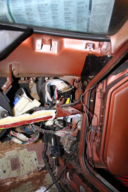

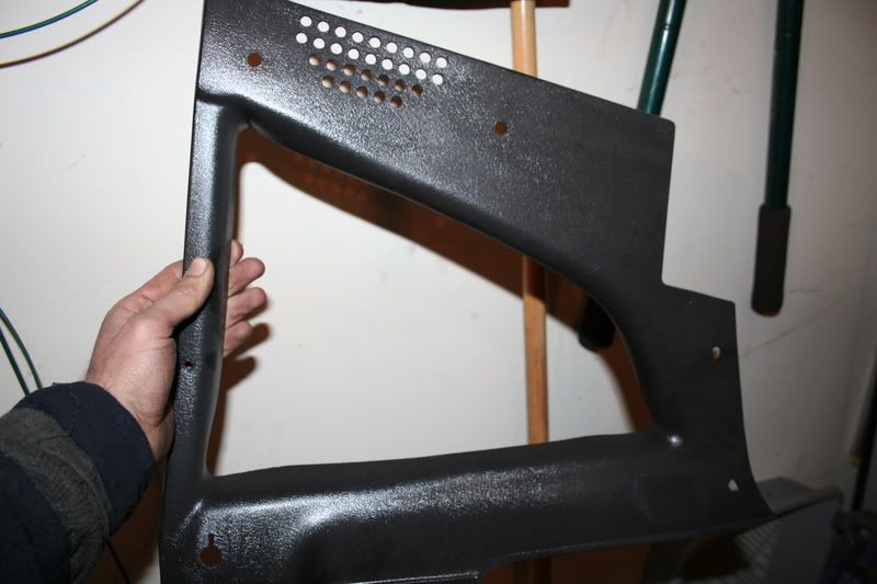

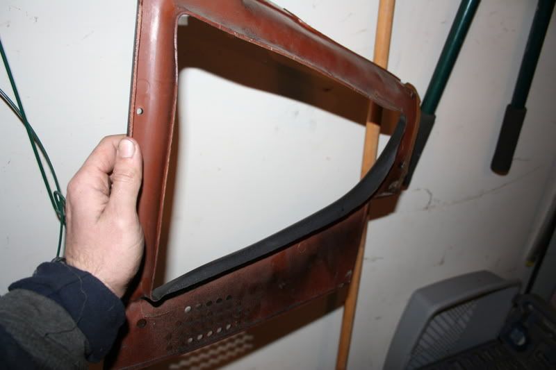

Oddmanout84 Posted January 26, 2009 Author Share Posted January 26, 2009 I'm not worried about the door panels, its more the rear panels in the hatch area. I'm not missing a screw, its just a matter of angling/bending the panel so I can pull it out. I gave my car its face back, just not the eyes. Quote Link to comment Share on other sites More sharing options...

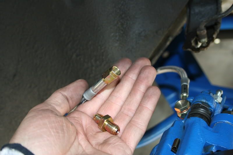

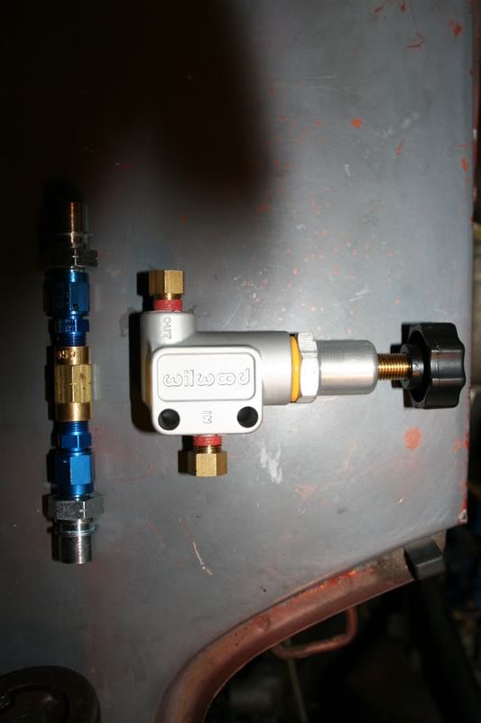

Oddmanout84 Posted February 9, 2009 Author Share Posted February 9, 2009 Now I feel really burned up. I had to cross my E-brake cables over 4 times to get the desired length... and they still look a little bit long! But the great thing isn't that. After I was finished I went to install the braided brake lines I got from MM with the rear disc kit. This is what I found. Passenger side Wow, that looks great. Even has a provision for the clevis pin to keep it in place. Driver side WTF is this? Not only is it different than the other side, but its also completely and utterly wrong. The adapter is threaded on the outside. The flares are incorrect. Why??! So once again, thanks MM. You've taken another few years off my lifespan and edged me closer to having an aneurysm than anything in recent memory. Not one purchase, but twice in a row. I can liken your products to a bowl of cheerios. Cheerios are great, I love them and they're good. But if there's one pea sized lump of crap in my bowl of cheerios, I don't want to eat them anymore. You pooped in my cheerios. Quote Link to comment Share on other sites More sharing options...
Oddmanout84 Posted February 9, 2009 Author Share Posted February 9, 2009 I got an email back from Modern about my concerns. Their customer service is great (when they're there), and now that I know the reason for the delay, its understandable. Still though, even the notes they pointed to about the rear disc installation still don't address the issues with the lines/fittings included with the kit. According to the notes, you also (in addition to the calipers) need to acquire "a 20 inch long metric male to metric male fitted Japanese hardline" for the driver's side. Uhh... I don't see this helping at all with my previous issues. There's already a nice line installed there. From examining the fittings on the new braided steel line, I'm almost absolutely positive that the problem can be solved with a -3 AN to Metric 10x1.0 female adapter w/ reverse flare. So I ordered a couple from Summit today (FINALLY found them!). If I've learned anything from this experience, its that there are a LOT more ways to measure a pipe fitting other than SAE and M. And that its damn hard to find anything but SAE fittings locally without special ordering. So, nothing much else new today. The clutch still works, much to my delight. Also nice to find out that I didn't screw up the bleeding by doing it all myself. Quote Link to comment Share on other sites More sharing options...
