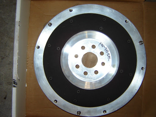

ShaggyZ Posted January 24, 2009 Share Posted January 24, 2009 with betamotorsports crossmemeber you dont even need a shifter extension.. mine fits perfectly in the stock location. i have a 2jzgte with a r154 the list you need~ 1jz bell housing to mate to the r154 1jz clutch/flywheel 2jz pilot bearing (autos dont come with it) 2jz throw out bearing then 7MGTE throw out bearing doesn't work? I thought it did. Speeder said he used the 7MGTE flywheel, but I believe he misspoke - the 7M's crank bolt-pattern is 6 holes, not the 8 of the 2JZ's. I imagine he did what I plan to do - get a non-turbo 2JZ flywheel and have the pressure-plate-to-flywheel bolt pattern matched to my 7M pressure plate I already have. 7M flywheel (aftermarket, I suppose) 2JZ flywheel (aftermarket, though) Regarding shifter extensions, some people are okay with how far forward the shifter is in the hole and some people don't want their engines all the way up against the firewall. There is/was a factory extension that cost $80 total to have your shifter come out about 1.5" further back than a stock Supra R154. I'll just wait and see where mine ends up and decide what to do. At most, I imagine I could be wanting 2" further back than what I'll end up with. Quote Link to comment Share on other sites More sharing options...
Overkill Z Posted January 26, 2009 Share Posted January 26, 2009 i would think that would work...but why go through the time of gettn the holes matched when a 1jz flywheel bolts right up? or did i miss read u? Quote Link to comment Share on other sites More sharing options...
ShaggyZ Posted January 26, 2009 Share Posted January 26, 2009 i would think that would work...but why go through the time of gettn the holes matched when a 1jz flywheel bolts right up? or did i miss read u?I'm assuming I can find a 2JZ non-turbo flywheel for $0-$20 and the modifications to it should be under $100. Let's say my numbers are a bit off and it comes out to $150 - I'm still more than $100 LESS than the cost of a new, OEM 1JZ flywheel. I've been having to pinch pennies lately and this is one more way to do it. Quote Link to comment Share on other sites More sharing options...
Overkill Z Posted January 26, 2009 Share Posted January 26, 2009 I'm assuming I can find a 2JZ non-turbo flywheel for $0-$20 and the modifications to it should be under $100. Let's say my numbers are a bit off and it comes out to $150 - I'm still more than $100 LESS than the cost of a new, OEM 1JZ flywheel. I've been having to pinch pennies lately and this is one more way to do it. i see, i just dont like the idea of drilln holes into a flywheel thats spinning so fast... Quote Link to comment Share on other sites More sharing options...
