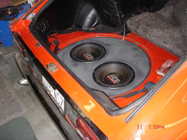

I'm pretty sure I've done this before but here ya go.
P-side amp is a 400 watt 2-ch for the subs (Coustic)
D-side amp is a 400 watt 4-ch Coustic for the other 6 speakers
2 subs in spare well are 10" MTX 4000 series
2) 6.5" in Kick pods are Alpine 2-ways
2) in doors are Kicker 4" 2-ways
2) in rear stock locations are Pioneer 5 1/4" 2 ways.
Deck is a Pioneer AM/FM/CD/XM stereo
Knob above radio (in old vent location) is sub amp control (Bass-knob)
Kick pods are hand made by me
Sub-enclosure is hand laid fiberglass by me
2 gauge power wire on battery to a distribution block then 4 gauge to amps
