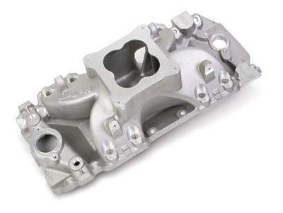

5litre z31 Posted January 13, 2009 Share Posted January 13, 2009 hello from downunder Grumpy I have a 280zx with a 283 with the basics stage 5 cam ballance mild heads turbo 200 r4 with 4.8 rear gears my question to you is a nitrous one, can I run a dual plane holly manifold without a spacer under the carby as in only the squirter plate . My concern is not getting even fuel nitrous mix thus causing piston burn as the single plane does have the divider still intact can you assist you normally have good info as I realy don't want to change intake manifolds but I have to I will main issue bonet clearance to carby its a sleeper thank you 5litre z Quote Link to comment Share on other sites More sharing options...
grumpyvette Posted January 13, 2009 Author Share Posted January 13, 2009 LOTS of guys have both hood clearance issues and a desire to keep their hood looking stock, but want to run a healthy nitrous system, on their dual plane factory intake so they won’t need to add a hood scoop. If your going to use a single spray bar nitrous system under the carb, a high rise single plane with a direct line of site shot from the plenum to the back of the intake valve in the heads is the PREFERED route with NITROUS I generally use this SBC intake. http://store.summitracing.com/partdetail.asp?part=HLY%2D300%2D110&autoview=sku or this one http://store.summitracing.com/partdetail.asp?autofilter=1&part=HLY%2D9901%2D101%2D1&N=700+303894+115&autoview=sku no the injector bungs are not a direct fit to the fogger nozzles but it speeds the conversion. http://store.summitracing.com/partdetail.asp?autofilter=1&part=NOS%2D02001NOS&N=700+115&autoview=sku But since you’ve got clearance issues and choose not to swap intakes, you can EITHER have the divider in the dual plane plenum removed by almost any milling machine equipped machine shop and have a reasonable component that should function, reasonably well, or take a different route, like I point out below, I doubt the dual plane/single spray bar will be AS effective at fuel/air ratio control but it should function, and there’s lots of guys doing that, so its not doing something totally new. OR you can insure equal fuel/air distribution and decent power with a direct port nitrous set up. Where, you’ll have each intake runner equipped /with a threaded bung with its own fogger nozzle. http://store.summitracing.com/partdetail.asp?autofilter=1&part=NOS%2D02462NOS&N=700+115&autoview=sku on BBC engines I’ve generally used the HOLLEY EFI intakes as they are pre set up to some extent. http://store.summitracing.com/partdetail.asp?autofilter=1&part=HLY%2D9901%2D209&N=700+303894+115&autoview=sku IF you don’t remove the plenum divider in the dual plane intake plenum, there’s a BETTER chance of having distribution issues but there’s lots of guys doing it successfully so it can be done, only testing will tell. BTW MOST FOGGER NOZZLES ARE THREADED FOR 1/16" N/P THREAD, so youll still need welding or epoxy to get them adapted & installed Quote Link to comment Share on other sites More sharing options...
