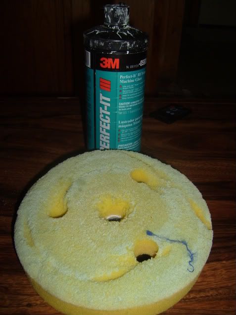

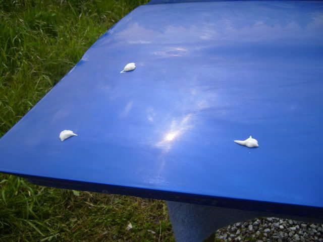

Globerunner513 Posted October 22, 2008 Share Posted October 22, 2008 This is just what I used. It's what I was told to do by the guy who did my paint job. I started with a really heavy cut. You'll use a lot of it, so buying one of these isn't a bad deal. These are the products I used. Hopefully it gives you an idea of what to look for. #1 Speed Cut Compound Heavy cut to take out the sandpaper scratches. Used with wool buffing pad. A mustard bottle worked out perfect to use and fill from the above posted tub. #2 3M Perfect-It III 05930 Machine Glaze Medium cut to take out the first cut. Used with foam pad. #3 Swirl Free Polish Final cut to take out swirl marks and any marks left from the medium cut. Used with foam pad Quote Link to comment Share on other sites More sharing options...

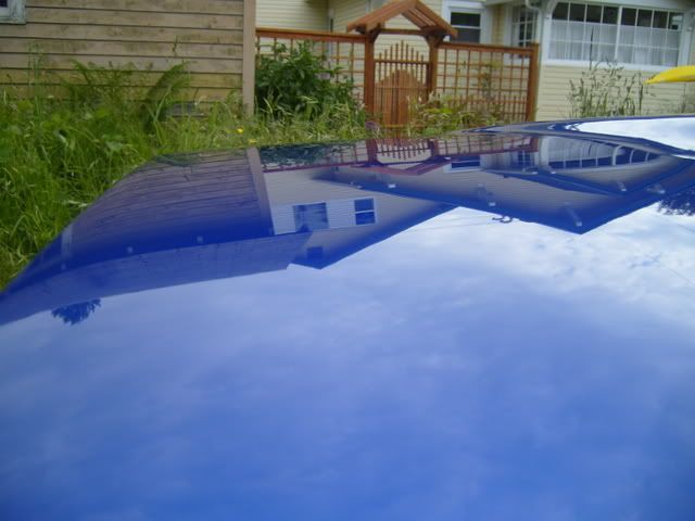

DuoWing Posted October 22, 2008 Author Share Posted October 22, 2008 Thanks for all the info guys. I went ahead and purchased a high-speed buffer from Amazon.com. It had decent reviews, had variable speed settings and wasn't too expensive. I figured even if it's not the best high speed at least it'll be something to start out and learn with, I could eventually then go high end. I've been sanding and sanding away. I've got the paint smoothed out alot. It's super smooth and when I look at it, I don't see the orange peel. When the water is over it the reflection is very clear cut where before you could just see it wasn't a smoothe reflection. Now I've just got to bring the color and everything back. I've searched for some tutorials and stuff, so I'm ready to give it a shot. Quote Link to comment Share on other sites More sharing options...
