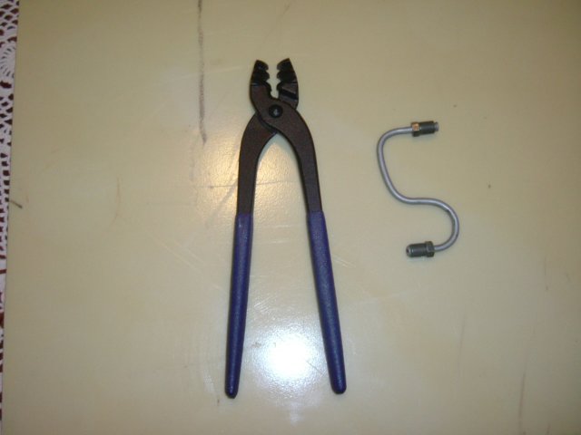

Dave Posted October 19, 2008 Share Posted October 19, 2008 Nice and clean installation. Where did you get the new lines? I'm planning to do the same since I need more room for a turbo down pipe that gets close to the stock front brake line. PaulR The line came from a local autoparts store. It's listed as 3/16" Japanese and the nut size is 10mm X 1.0, The tube comes in 8", 12", 20", 30", 40", 51" 60" and 72". I used a pair of brake line bending pliers like the ones pictured below. Bending the lines is very easy with the pliers. Some of the larger radius bends are can be done by hand but come out nicer if you wear a good pair of gloves instead of doing it bare handed. Quote Link to comment Share on other sites More sharing options...
mossy74 Posted October 22, 2008 Author Share Posted October 22, 2008 Nice lines Dave, I think I may have to buy one of those tools myself. Quote Link to comment Share on other sites More sharing options...
