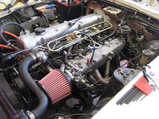

FlatBlack Posted October 29, 2008 Share Posted October 29, 2008 So... Why do you have the radiator hose butted up to the intake? Quote Link to comment Share on other sites More sharing options...
TrumpetRhapsody Posted October 30, 2008 Author Share Posted October 30, 2008 To keep the air warm, duh Ok so my plugs are indeed firing, but I'm having other issues. I thought my O2 wasn't working, as it's been pegged at 20.6 or so until tonight. The lowest I got it to was 16.3, but that was briefly. In an attempt to get a solid idle, I've been tweaking on my VE table. My MAP has been idling around 80kpa + (way to high), and by richening it up little by little I've gotten it down to 70kpa so far.The problem is, as I richen it up and my afr's become reasonable, the car backfires A LOT. It's too loud to work on anymore tonight. Quote Link to comment Share on other sites More sharing options...

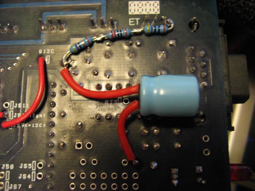

TrumpetRhapsody Posted November 6, 2008 Author Share Posted November 6, 2008 Lockups solved, thanks to jeffer949 for the DIYefi link and suggestion! http://www.diyefi.org/forum/viewtopic.php?f=6&t=285&st=0&sk=t&sd=a&sid=f34d645f34003cd4f1ecb13594549e36&start=10 The thing that, in addition to the above mod, fixed my lockups was plugging the usb-serial adapter directly into the laptop with a hefty serial cable going from it to MS. Quote Link to comment Share on other sites More sharing options...
