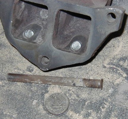

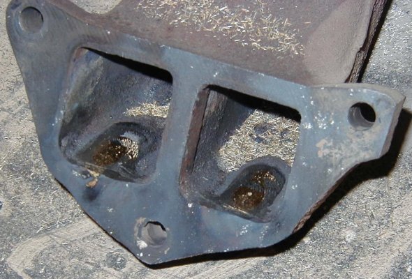

Racer Z Posted December 5, 2008 Author Share Posted December 5, 2008 In the end I did pick the one that fit the best, the 73. The other one has the exhaust flange in a different position and would require re-doing the collector and exhaust pipe. I was able to weight them and the 72 is 15 pounds compared to the 73 at 25 pounds. Ouch. I think the 72 might actually flow better and my brother thinks the 73 will. In truth, the header is probably not the weakest link here, nor is the carburetter. The head or valves and cam are probably the deciding factor for flow on the stock motor. I went to my Dads shop and filled in the EPA fresh air ports in the header. Took me about 4 hours to hog out the humps in the ports. Then i drilled out the passage and slipped a steel dowel in and braised it solid. After it cooled slowly I finished the port and polish job. Nothing fancy, just removed the worst of the hump. I took a gazillion pictures and will post a few later. Quote Link to comment Share on other sites More sharing options...

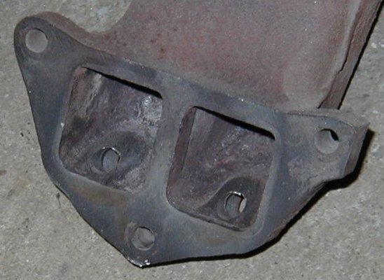

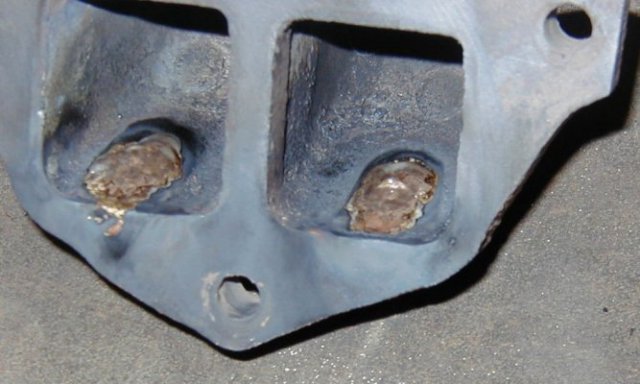

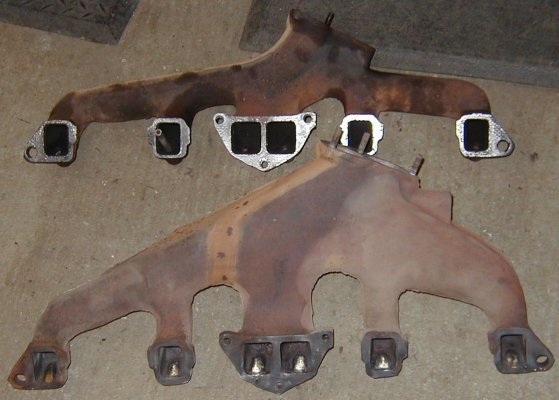

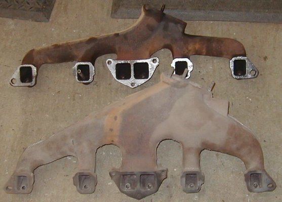

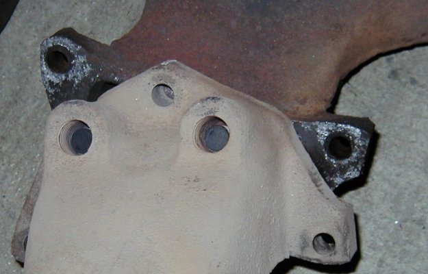

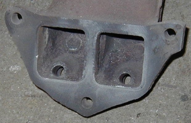

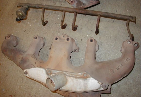

Racer Z Posted December 7, 2008 Author Share Posted December 7, 2008 I took some photos of the before, after and progress of filling in the EPA Fresh Air Ports in the 73 exhaust header. Some of the close ups are a bit fuzzy, but the header is installed and this is what I've got to share. Filling in the EPA Fresh Air Ports (left to right, top to bottom) BEFORE - The 72 header on top and the 73 header that I used. Close up of the 3-4 ports before grinding off the humps and filling in the fresh air ports. I ground off the worst of the hump inside the chamber. I drilled out the fresh air port to 3/8 inch and cut 3/4 inch off a steel dowel to fill in the hole. The original air tube is shown for effect. I braised the steel dowel in and filled the small cavity. I then ground it down some more and smoothed it up some. I did a pseudo polish job, but the picture is to fuzzy to bother showing. The finished outside. You can see the steel dowel. The finished header with the air injector that's going in the scrap pile. AFTER - The finished 73 header (bottom) and the original 72 header. Now it is time to thank my father for letting me use his machine shop and his guidance in this project. Quote Link to comment Share on other sites More sharing options...
