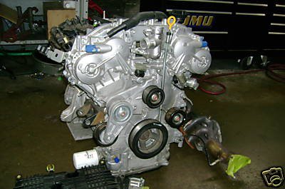

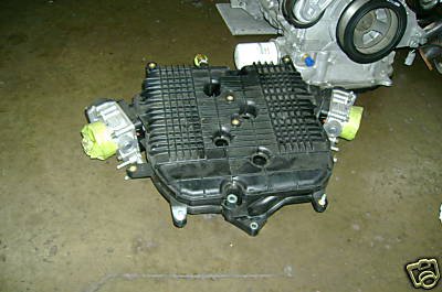

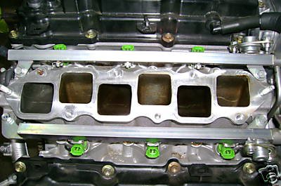

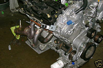

Pharaohabq Posted December 15, 2008 Share Posted December 15, 2008 (edited) I'm starting to amass parts for my VQ powered 280z. I've got a 280, I just bought what they said is a VQ35HR from an 07 350Z. The engine should be here next week and I can post better pictures. From what I can tell this engine uses two throttle bodies. I'll have the wiring harnesses, but I'm going to be looking for ECU/BCU for it, since the engine didn't come with it. (I'm paying $900 for the engine alone, so that's a pretty good deal, if it is all that they say it is.) Though there's another 03 VQ on Ebay right now for 900 as well, but I wanted the 07.How much do you all know about the VQ35HR, as compared to the VQ35DE? I would assume most of it is the same, though I imagine a DE ECU won't work with an HR engine right?I want to stick with stock electronics, just for the ease of wiring, but an HR ECU isn't very common.Aside from the throttle bodies, are there any other obvious differences between the engines?I'm looking for a 6sp tranny cheap, if anyone has a line on one.240hoke, I might want one of your tranny adaptors too.Phar Updated HR picts: Plenum: Engine front: Intake ports Left side of engine sans PS, Alt. Engine Wiring harness: Edited July 1, 2013 by Pharaohabq Quote Link to comment Share on other sites More sharing options...
xlr8r Posted December 16, 2008 Share Posted December 16, 2008 The HR engines are far superior internally to the DE engines. They have 20mm taller decks/longer rods for higher revs, better rod bolts, better water passage/cooling setup, oil pumps, cams phasing on intake & exhaust, blah, blah, blah. Great engine, but yes, it will be hard for you to find an OEM ECU to run it. Also, the 6spd trans has to be from an 07-08 as well since earlier 6spds. have different bell housings. Quote Link to comment Share on other sites More sharing options...
Pharaohabq Posted December 16, 2008 Author Share Posted December 16, 2008 The HR engines are far superior internally to the DE engines. They have 20mm taller decks/longer rods for higher revs, better rod bolts, better water passage/cooling setup, oil pumps, cams phasing on intake & exhaust, blah, blah, blah. Great engine, but yes, it will be hard for you to find an OEM ECU to run it. Also, the 6spd trans has to be from an 07-08 as well since earlier 6spds. have different bell housings. Thanks, yeah, I'm still learning the differences in the trannys n such. The ECU/BCM combo will be the hardest part I think. but maybe I'll get lucky.. Where do you find your information on the HR? Oh also, The wiring harnesses, Does anyone know if the passenger compartment harness changed between 06/07? I imagine the ECU and BCU are probably paired, so I'll try to find the brains from the same source. but if the interior harness didn't change then it'll be a lot easier to find one. Anyone know where I can find a 350z FSM? Thanks, Phar. Phar Quote Link to comment Share on other sites More sharing options...

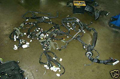

irax Posted December 17, 2008 Share Posted December 17, 2008 Thanks, yeah, I'm still learning the differences in the trannys n such. The ECU/BCM combo will be the hardest part I think. but maybe I'll get lucky.. Where do you find your information on the HR? Oh also, The wiring harnesses, Does anyone know if the passenger compartment harness changed between 06/07? I imagine the ECU and BCU are probably paired, so I'll try to find the brains from the same source. but if the interior harness didn't change then it'll be a lot easier to find one. Anyone know where I can find a 350z FSM? Thanks, Phar. phatg20.net will have fsm... maybe not 08's but should have 05/06 maaybe 07 I would recommend getting getting the wiring diagrams from AHDOL.com thats where i got mine for my 02 maxima since thats the ecu i'm using. Quote Link to comment Share on other sites More sharing options...
240hoke Posted December 17, 2008 Share Posted December 17, 2008 Service Manuals, free and for every year: http://www.350z-tech.com/zwiki/Service:Index Doesn't matter what BCM you have it can be reset to work with any key or ECU at the dealership. I doont know about BCM variations between the years though. I have a spare one if you need one, its from a 04 though I think. Quote Link to comment Share on other sites More sharing options...
Pharaohabq Posted December 17, 2008 Author Share Posted December 17, 2008 nice! found the 07 FSM on there, that'll help a lot. I'll look into the wiring diagram, that could be really helpful. I might be interrested in the BCM, but I'll need to check on model specifics, and see if I can get one with an ECU or not. I understand if I get them all from the same car, then likely I wouldn't have to have a dealer reset them for me. that may not be possible tho. Phar Quote Link to comment Share on other sites More sharing options...

Pharaohabq Posted December 22, 2008 Author Share Posted December 22, 2008 okay, so I guess nobody bought that 03 off Ebay, ended w/ 1 bid, lucky guy. So my engine showed up today, I was going to take some pictures when I got home, so I'll post those later. Initial look, it looks prettty darn good. No shipping damage. clean clean too, looks new. The intake needs to still be tightened down, but it looks like it's all there. I thought it came with Cats, but I guess those weren't included. I'll have to see what I can find there, later on. Wiring harness, I need to go through, but I didn't see any cut wires. It has the flywheel, but no clutch bolted on so I'll have to find one of those too. All in all it looks pretty sweet. I gotta find an engine stand, to make it easier to go through the engine. I was thinking I might take off the oilpan and look at the bottom of the cylinder sleeves. I'm not sure if I should risk opening the bearings to check them out n risk anything. I guess if there's a problem w/ the engine there might be shavings in the pan. Always stuff to worry about when buying a cheap used engine. Anything else you guys think I should check out before continuing my build. I'll post picts soon. Quote Link to comment Share on other sites More sharing options...

Pharaohabq Posted December 30, 2008 Author Share Posted December 30, 2008 yeah, so I didn't get a lot done this week since I've been down w/ a cold, and there's no heat in the garage. I did inspect the new VQ a little. looks like I'll need to find some Cats, a clutch pressure plate and clutch assy. the Wiring harness doesn't look to be cut, but it's going to be fun figuring out where everything goes. I know I won't need everything, but since it's there, I might leave a lot of it, but just put labels on everything. We'll see. So, for now, holding on health, weather and parts. Now an 07 ECU is proving difficult to find too. cheap that is. Phar Quote Link to comment Share on other sites More sharing options...
