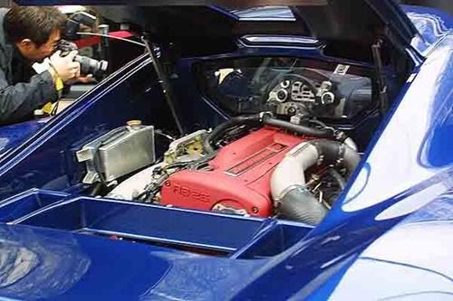

cheftrd Posted January 17, 2009 Share Posted January 17, 2009 I've seen a few of the Tommikairas. They don't use the stock tranny. It's completely custom engineered. You're best bet (if you have the space and limited funds) is to use it in true mid-engine format (engine first, tranny in the rear). Eliminate the rear prop shaft and lock out the transfer. The transfer is simply a hydraulically applied clutch drum with chain to the front shaft. There are a host of problems with the front drive differential and axles when you start making serious power in the GT-R. And that's on the no-traction half... Quote Link to comment Share on other sites More sharing options...

cheftrd Posted January 19, 2009 Share Posted January 19, 2009 Looks like the easiest route may be to use it like the TommiKaira set up with the engine in the rear and the trans in the tunnel. You'd have to eliminate the stock pan-differential and go with a different diff that drives forward with clockwise rotation when viewed from the rear of the car. Even then, I wouldn't count on much power. The shaft from the transfer to the front diff is a joke. See attached. The splined shaft is less than 28mm in diameter. That has to drive the whole car... Brings new meaning to the phrase "Oh Snap!" Quote Link to comment Share on other sites More sharing options...
