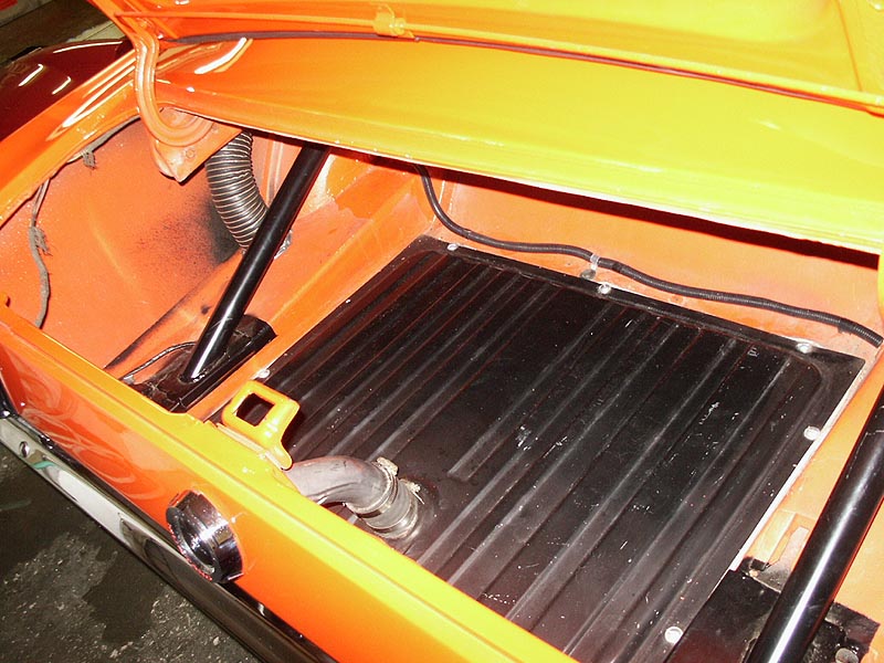

AkumaNoZeta Posted June 1, 2009 Author Share Posted June 1, 2009 Hey, I have another question to add. I got to look at a friend's 65 Mustang coupe and I looked in the trunk and I saw that they have a gas tank that's mounted kinda as the floor. Here's a picture I found to describe what I mean http://www.jagpromotions.com/forsale/ford/trunk1.jpg Now if this tank was swapped into the Z chassis, would it still need all the caging to be SCCA legal? Quote Link to comment Share on other sites More sharing options...
