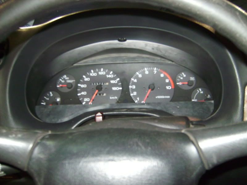

scottyMIz Posted February 10, 2009 Author Share Posted February 10, 2009 well got the cluster put in(thanks jitter) here it is oh yea and i got the right maf on it now idles like a dream. Quote Link to comment Share on other sites More sharing options...
Racinjitter Posted February 11, 2009 Share Posted February 11, 2009 How did you get that paint off of it? Obvioulsy I didn't try very hard. Does everything work properly? Quote Link to comment Share on other sites More sharing options...
scottyMIz Posted February 11, 2009 Author Share Posted February 11, 2009 yea everything works good, gonna have to figure out the fuel gauge and get a speedo cable. It's nice to have a tach!! lol its definately doing over 70mph in second gear, i checked it yesterday on the way home coming out of caseville. I used wax and grease remover on it, had to rub pretty hard but it came off. What did you want for the gauges? Dan said u wouldnt take any money for them. Quote Link to comment Share on other sites More sharing options...

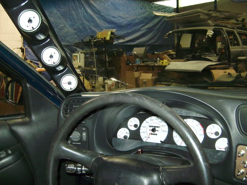

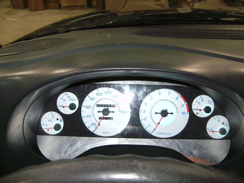

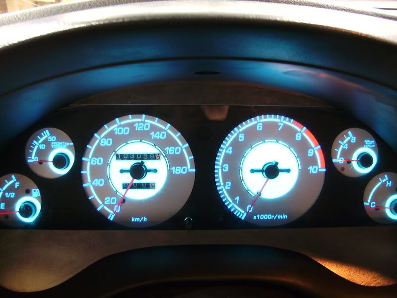

scottyMIz Posted February 18, 2009 Author Share Posted February 18, 2009 ok guys got the gauge over lays put on andthe speedo hooked up here are some pics they look sweet in the dark the pics dont do it justice, there is more blue in the lights than it shows. but i love the way it looks now Quote Link to comment Share on other sites More sharing options...
ShaggyZ Posted February 18, 2009 Share Posted February 18, 2009 Looks cool. The only thing I would change now is to get that metal plating to look like the overlay (ie paint it black) or make it all one piece. Quote Link to comment Share on other sites More sharing options...
