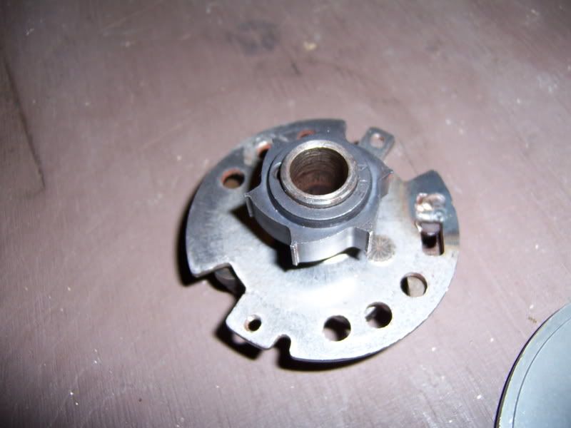

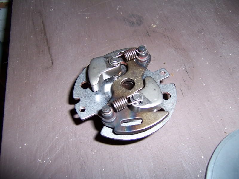

ok, i got a rare setup for my supra and it has a mechanical advance mechanism in it and i dont knwo what its from. the magnetic pickup is from a 82 5mge distributor, but the mechanical advance and wheel arnt. ive been searching google for hours to see the internal setup on diff nissan v6 distributors with no luck. the reason i think it may be a nissan part is because the distributor cap and rotor that mounts to the back of the other cam is from a 89-94 nissan maxima. if anyone recognizes the parts in these pics PLEASE lmk what they are from. lol. that way in case i ever need to replace something, like the bushings for the weights like i need to replace now, i can find them.

Ok, so to revive this from the depths. lol. It is not my primary project, so that is why it has been a decade. lol. I have bought five 45 DCOE carbs. I have a matched set of 45 DCOE 9's, and a 45 DCOE 13, and 45 DCOE 45 as spares for parts, so I am back to investigating things for this build.
I found that this reluctor is from a 79-81 280ZX.

I am still trying to figure out where the weights came from. Hard to find pics of the inside of distributors. I am thinking maybe a l20 or something else that is compact. Anyone seen one to know? Main thing is I want to grab springs etc.. to change the timing curve if needed, but also I need bushings for the weights. We put Heat shrink on, and it seems to be a good fit, but I am worried it will not hold up very long at all. THe old worn out ones were some sort of plastic. Same for the throttle shaft that actuates all 3 carbs, but I bout needle bearings for those. These are far too small.
