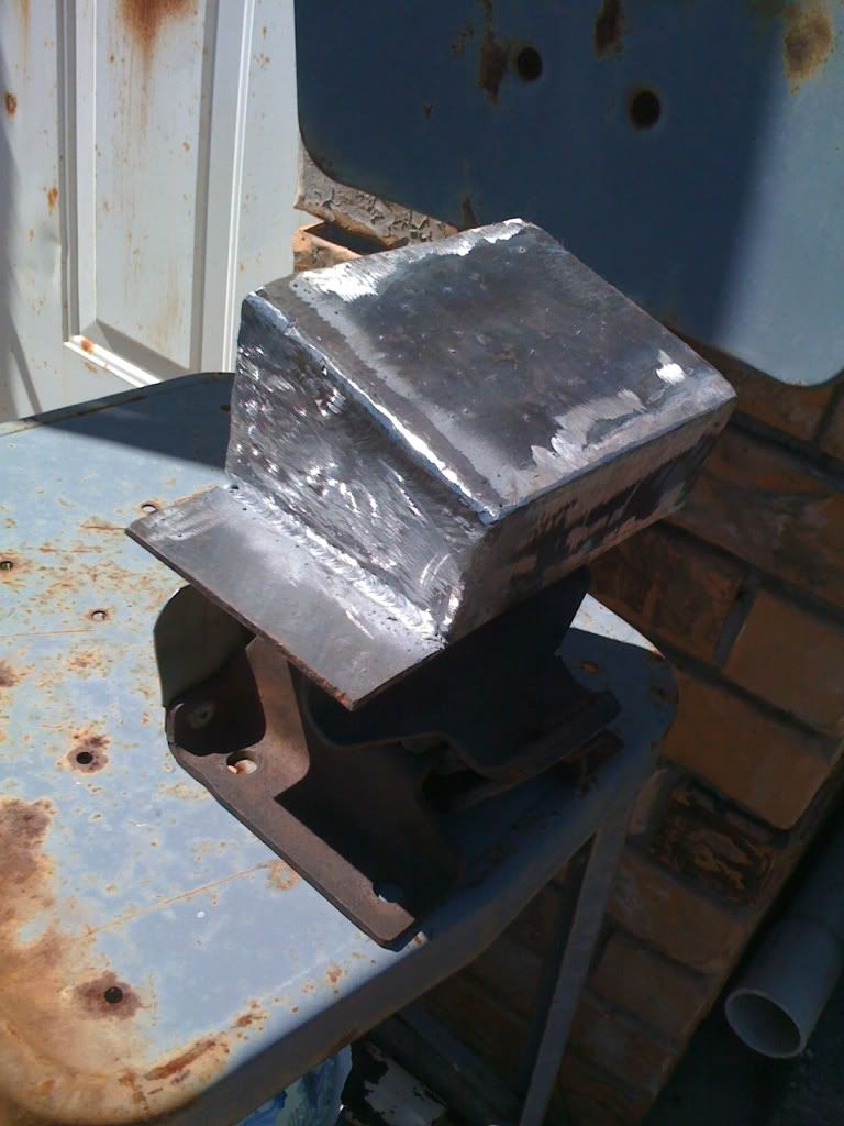

ragefear Posted March 12, 2009 Share Posted March 12, 2009 lookin good man! I can't wait to see the completion of this. So the mounts are 100% fabricated, eh? Ever think of building a few of them and selling them to the masses? whats up with the wood laying on the ground in that one pic? Was it a roof or something? Quote Link to comment Share on other sites More sharing options...
meindaparish Posted March 12, 2009 Author Share Posted March 12, 2009 I could make a few for people if they really wanted them. I just dont wanna deal with any lawsuits or anything if something breaks!! lol Not that I dont trust my welds or anything, but you know how it goes. When everything is 100 % i will give some good pics and measurments. And that wood on the ground is the wood flooring left over from the house that was there. When they demolished the house, they didnt pull up the wood flooring off of the slab. Quote Link to comment Share on other sites More sharing options...

meindaparish Posted April 14, 2009 Author Share Posted April 14, 2009 So I finally got back to it today.... been waiting on time and funding(aren't we all!) I finally completed the motor mounts 100%. Just gotta paint em now. They came out well, definitely think they will work great. The good part is, you can drill the hole where ever you want, so I can move the motor slightly forward or back. The other side is open so you can get the the bolt/nut. Ill post more pics later Quote Link to comment Share on other sites More sharing options...
