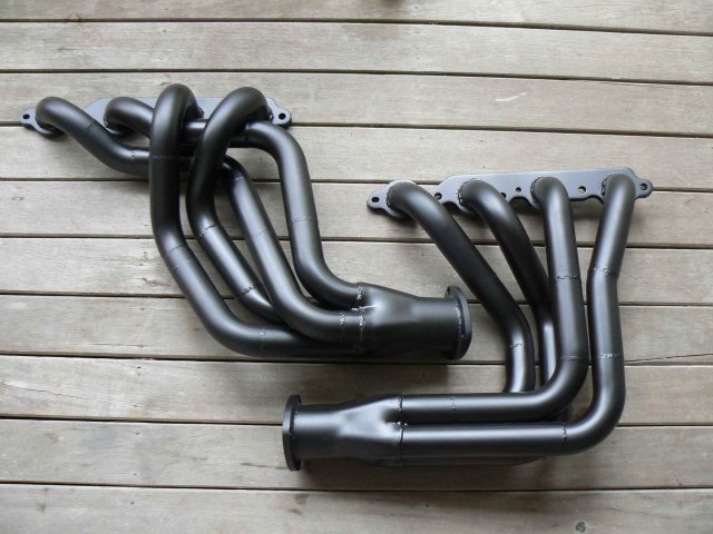

towbar Posted January 30, 2009 Share Posted January 30, 2009 Hi Guys This is my first post. I'd like to share with you a picture of the Long Tube headers I built for my LS2 engine. I just got them back from HP coatings. Yes, it Can be done! The car is a RHD 260Z using a John's Cars mounting kit. I'd just like to say how good this forum is. Such a wealth of info. And so many people serious about their Hybrid Z cars. Awesome! Jeremy Quote Link to comment Share on other sites More sharing options...

jt1 Posted January 30, 2009 Share Posted January 30, 2009 Towbar, those look nice. What primary and collector diameter did you use? Were you able to keep the tube lengths pretty close? That's some nice work. Welcome to HybridZ. John Quote Link to comment Share on other sites More sharing options...
towbar Posted January 30, 2009 Author Share Posted January 30, 2009 Thanks for the positive comments. Some extra info- Primary diameter is 1 7/8". Collector is 3". I did make an effort to keep the runners a similar length (around 27" as it turns out) but obviously there were some space constraints. Quote Link to comment Share on other sites More sharing options...

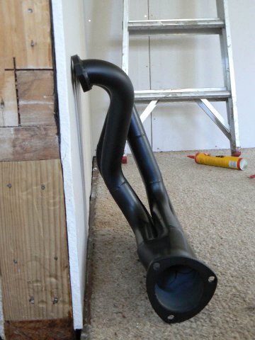

towbar Posted February 5, 2009 Author Share Posted February 5, 2009 Thanks Mick I had one or two mishaps buliding mine too. I guess the odd thing about my drivers side header is that the steering column passes Through it. It seemed to me like the only way of finding the room. See the attached picture of RH header. N.B. The pipe diameter is actually 1 3/4 inches, not 1 7/8 as previously stated, my mistake. Jeremy Quote Link to comment Share on other sites More sharing options...
zed240au Posted February 6, 2009 Share Posted February 6, 2009 yeah have to agree that run steering coloum through center of pipes is the best way for it I did mock headers like that but got put off when couldnt fit them with engine in place might tackle a set now ive seen them made but will enjoy car a bit first with the ls1 in it but you have given me the inspiration to try long tube headers again when i get a week to try thanks mick Quote Link to comment Share on other sites More sharing options...
towbar Posted February 6, 2009 Author Share Posted February 6, 2009 Yes, enjoying driving the car is something I haven't done yet. The most important bit I reckon. My headers won't go in with the motor fitted. From memory that is more to do with the length and angle of the collector than anything else. Best of luck if you decide to have another go. Jeremy Quote Link to comment Share on other sites More sharing options...
