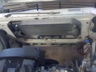

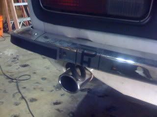

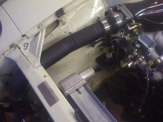

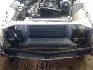

dizzle Posted March 13, 2009 Author Share Posted March 13, 2009 Well I just got the car back yesterday. They did a SWEET job, worth the money for sure. This is what Modern Automotive Performance did; 3" turbo back exhaust Magnaflow 3" straight thru muffler w/ vibrant resonator Custom rear tranny mount (to allow extra clearance for exhaust) new intercooler mount new black wrinkle powder coated intercooler charge pipes mitsu 1g eclipse BOV welded onto intercooler Oil and return lines The exhaust turned out great! They took a lot of time into making sure it tucked up tight to the chassis. the charge pipes fit perfect and the intercooler moved forward and down for more air flow. All that is left is the fuel system, and she will be ready to start! gettin so close... Quote Link to comment Share on other sites More sharing options...

sqweekykneecap Posted March 13, 2009 Share Posted March 13, 2009 niiice, i have never seen a bov mounted directly to an inter cooler. that rb looks nasty sittin in ur s30 man. cannot wait to start mine!!! Quote Link to comment Share on other sites More sharing options...
