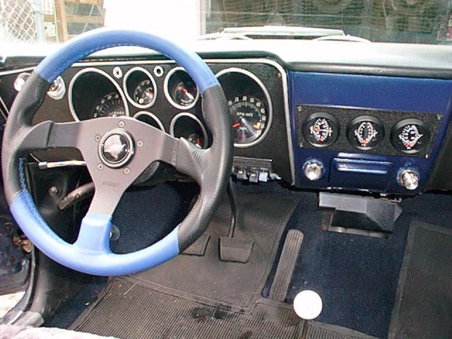

ezzzzzzz Posted March 2, 2009 Share Posted March 2, 2009 Thanks for the compliment. See http://forums.hybridz.org/showthread.php?t=143072 and look at post #7 for a few pictures. I made this out of a piece of nylon round stock and leds. Quote Link to comment Share on other sites More sharing options...

Young Z Posted March 4, 2009 Share Posted March 4, 2009 I'm almost done mounting my Omori Gauges in my 280z's dash pods. It took a little bit of work to get em in there but they look pretty good. I'll try and snap some pics later today. Quote Link to comment Share on other sites More sharing options...

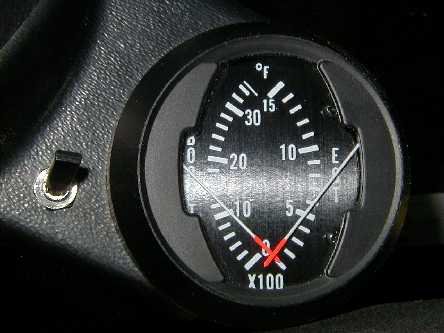

getoffmyinternet Posted March 19, 2009 Author Share Posted March 19, 2009 Hard to see what they are, and who makes them? please elaborate. Part of the problem is often that combo gauges don't come in convenient packages. I mean I've never seen one that did oil pressure and batt amps etc. They are usually oil pressure and temp, water pressure and temp, etc. involving something I don't really desire. Quote Link to comment Share on other sites More sharing options...
jeff81 Posted March 23, 2009 Share Posted March 23, 2009 The gauges that I am looking into are Westach Gauges. They make any combination for a relatively reasonable price. Quote Link to comment Share on other sites More sharing options...
rsicard Posted March 24, 2009 Share Posted March 24, 2009 The gauges that I am looking into are Westach Gauges. They make any combination for a relatively reasonable price. Jeff: Thanks for the post. Strongly considering using Westach Gauges to replace the dual gauges in my 240Z. Went to Westach Gauge site and surprisingly found out that custom dual gauges can be ordered. The only questions concerning them are the sensors and the night lighting quality. Other than that, I think they should be fine. Quote Link to comment Share on other sites More sharing options...
jeff81 Posted March 24, 2009 Share Posted March 24, 2009 I am a little curious about the lighting. I called them and things sound really good. I just have had problems finding equivalent dual gauges, but they look pretty cool. I am hoping to have everything dealt with and finished by May... I will post pictures of anything and maybe these will be on it. Quote Link to comment Share on other sites More sharing options...
getoffmyinternet Posted March 24, 2009 Author Share Posted March 24, 2009 I already failed on getting gauges that look like the go together as a set. I bought an msd lazer tach/boost for cheap, but soon after realized they don't even make speedos! What the french, toast? I'll have to find another one that looks good enough, or similar enough. The tach does look beautiful though, hopefully when I get it and it lights up it will meet my expectations. Does westach make the dual sweeps horizontal like the stock gauges? I'm not to crazy about the vertical ones myself, after seeing them on the dash, they just look funny for some reason, hard to get used to. Having the needles follow the circumference of the face seems to make the most sense to me. Quote Link to comment Share on other sites More sharing options...
