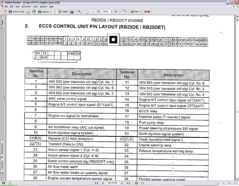

jtmny1999 Posted March 11, 2009 Author Share Posted March 11, 2009 \ said: Ok so I tried the laptop using battery and it did the same. Now I found something interesting. First time i wired my cable I followed these directions below from Jerry @ hybridZ Blue = [Clock pin #31 yellow/red] White= [tx pin #22 solid yellow] Yellow= [rx pin #21 brown/yellow] When I have it wired like this it will not read cpu gagues nothing at all. when i start the car it will still freeze the software. Thats how I first had it wired with no success. Well I thought I had mixed up the wires so I tried again and wired it this way. Blue = [Clock pin #31 yellow/red] White= [rx pin #21 brown/yellow] Yellow= [tx pin #22 solid yellow] This way is how I currently have it set at this time and this is the only way it can read the ECU and gagues' date=' but then again I freeze up after start up. Original Instructions Quote The blazt cable colours should match up to the Pin positions in this fashion...Power can be any 12V source prefer ignition source...ground is ground...... Red - Power Black - Gnd Blue - Clock ....... Pin # 31 Diagnostics Clock White - Tx ....... Pin# 22 Diagnostics Send Data Yellow - Rx ....... Data Pin# 21 Diagnostics Receive Data Chk position 47 is not required for NDS software.] FSM RB25det Pin out. Quote Link to comment Share on other sites More sharing options...
