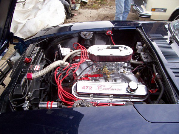

Dat260 Posted March 17, 2009 Share Posted March 17, 2009 Here is the caddy engine. Quote Link to comment Share on other sites More sharing options...

HowlerMonkey Posted March 26, 2009 Share Posted March 26, 2009 I test fitted a merlin 9.4 liter (572) and it went right in. It seems the ford modular engine is damn wide and you might have trouble fitting it. I've seen the caddy 500/501 in a 910 maxima and I really love that pic of the 472 but your choice may depend on availability of parts since that pic above probably has most every performance part made for the caddy engine in one place. Quote Link to comment Share on other sites More sharing options...
