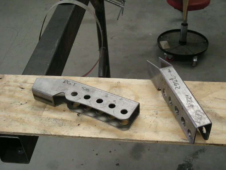

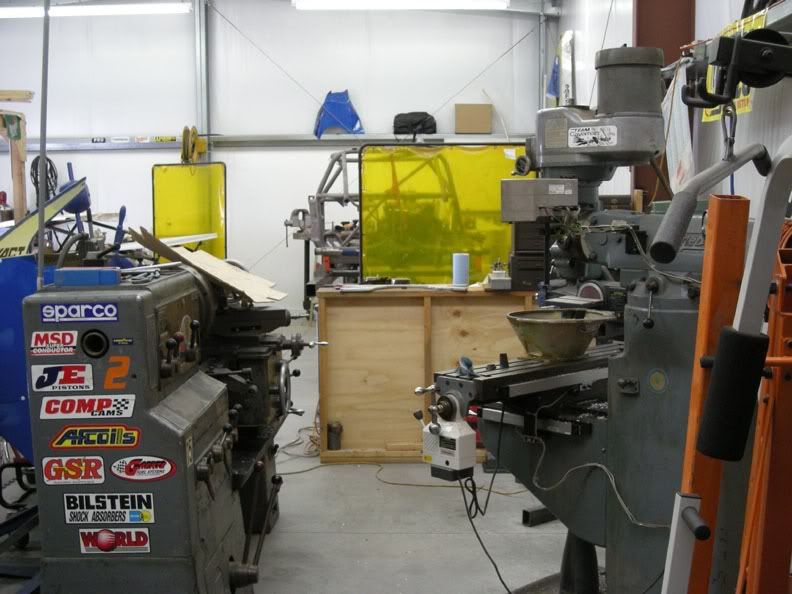

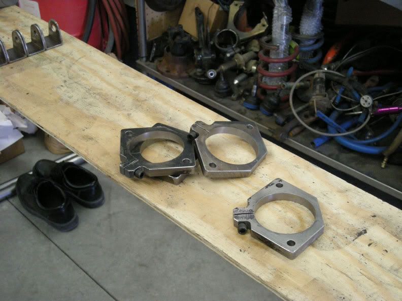

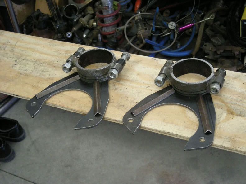

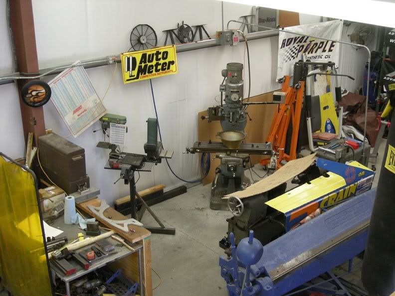

canyoncarver Posted June 27, 2009 Share Posted June 27, 2009 I've been involved with machining parts for a little while. In my opinion you guys will be better off buying a nice used Bridgeport as opposed to alot of that Chinese crap. Good used Bridgeports can sell for more than a new import. There is a reason for that. If you want the capability to machine round parts, as you might on a lathe, but without buying a lathe, a nice additional investment can be made in a rotary table. This gives you the ability to rotate the part around the cutting tool. Here are some pics of my Bridgeport and a friend's lathe. I picked the mill up for $2500 and it had new digital readouts and power feed. Here are some non-z related car parts that were done on the Bridgeport with rotary table. The lathe is a 1960's german brand. If you want to remove .001", you dial .001", and that is how much material is removed. Quote Link to comment Share on other sites More sharing options...
