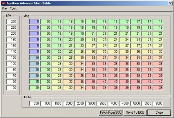

delorean6584 Posted May 17, 2009 Share Posted May 17, 2009 Hi all, i finally got able to drive the car all week long to tune the megasquirt on my 280zx !! under low boost/vacuum ive been able to acheive great results, got the air/fuel to about 12-13 all the way, then 11-11.5 under all boost conditions, the thing is that i have alot of pinging over 10psi of boost wich in 4th gear is like 2500-3000 rpm, its very low so i cant imagine at WOT !!! i used the metro tables for timing and fuel, i only tweak it by 1 or 2 points under 100KPA wich the boost begins, so i know that i have enough fuel caus its about 11 to 1 when it pings and between 26 and 30 of timing...i also have about 82 degree faranhiet as intake temp i am also very confused about the psi to kpa !!! the map sensor in megasquirt is connected at the same place as my boost gauge...0 psi (say just after vaccum and before beginning to boost i have 100kpa on megasquirt....but if you convert 100kpa in psi it gives 14 psi ???? what the ? any ideas ? my setups is : stock 1982 l28et megasquirt II v3.0 stock injectors/turbo/wastegate etc... custom IC piping godpseed intercooler greddy blow-off valve custom boost controller lc-1 wideband gauge (not connected to ms2) Quote Link to comment Share on other sites More sharing options...
slown280z Posted May 17, 2009 Share Posted May 17, 2009 I think you might be running a tad too much timing. 1 range colder plugs, a 180deg thermostat, and a good coolant system go a long way with keeping ping at bay. Make sure your cooling system is up to snuff, run higher octane gas, and pull a few degrees of timing. Quote Link to comment Share on other sites More sharing options...
delorean6584 Posted May 17, 2009 Author Share Posted May 17, 2009 i have bpr6y from ngk right now... how much timing down should i go with ? the cooling system is all good, new radiator, 180 thermostat, new coolant, i also noticed that my head temp sensor is showing 212 degree faranheit in megatune...i imagine the head is hotter than the rad...do you have the same ? heres my timing map Quote Link to comment Share on other sites More sharing options...

dexter72 Posted May 18, 2009 Share Posted May 18, 2009 From what I have read on this forum you need to reduce timing more when you up the boost. Try reducing the timing another 8 degrees and see if it still pings. If it stops, then increase timing 2 degress at a time until it pings again. Try the colder spark plugs and reducing the spark plug gap also. Quote Link to comment Share on other sites More sharing options...

delorean6584 Posted May 18, 2009 Author Share Posted May 18, 2009 thanks for clearing that up ! but now i am tottaly out of ideas !!! i put colder plugs on the engine, put high octane gas in the tank, tried to lower the advance by 10degree, wich gives pinging at 9degree of advance ????, i also tried to up the fuel to 9:1 air/fuel and i still have pinging issues depending on the gears it begins to ping from 7 to 13 psi(boost gauge) cooling system is all new, head temp and intake air temps is good too... i just can't figure it out... Quote Link to comment Share on other sites More sharing options...
ktm Posted May 18, 2009 Share Posted May 18, 2009 What do you mean you used high octane gas? If you used 100 octane, you should not be pinging at ALL with that timing table assuming your fuel map is correct You have an Innovate LC-1. Are you recording your AFRs with Logworks? If not, you should and then post them here. I have an LC-1 and LMA-3 auxbox (with built in RPM converter) that I use to tune with. I have a feeling that you are going lean in places on your map. Your wideband is not hooked up to MS, therefore you must be looking at your gauge to determine your AFRs. I am not familiar enough with MS, but I believe that a large part of your problem may be attributable to not having your wideband hooked up to MS. MS is unable to determine your AFRs and therefore not use them in any calculations if you are trying to use its autotune features. You keep saying you adjusting your AFRs, how? By modifying the AFR table? This is useless if you do not have your wideband hooked up. Quote Link to comment Share on other sites More sharing options...
