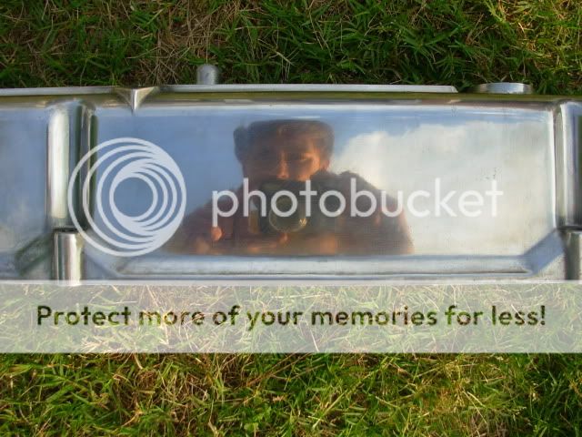

S130Z Posted June 1, 2009 Share Posted June 1, 2009 Well I just got finished polishing and painting my valve cover. This was not one of the more fun things that I have done with the ZX. I started off with a 220 grit and worked my way up to 1000. Then I used 2 different grits of polishing compounds(red then grey) on a cotton wheel hooked to an electric drill. I also used my dremel for some of the tight spaces. Although I missed a bit of small spots, but it looks good enough for me. It took me a total of about 7 hours of labor, that includes the 2 times I dropped it and had to resand some spots. I have not gone with an aluminum hand polish yet, so I'm sure it can get a little bit more shinny. Here are some Pics..... I have great respect for the people who get these looking 100% as this takes a lot of labor and patience. I had a very little idea of how to polish aluminum when I started, but I'm sure if I could do it again, it would end up looking better. Quote Link to comment Share on other sites More sharing options...

Administrators BRAAP Posted June 2, 2009 Administrators Share Posted June 2, 2009 Cool mirror.. Quote Link to comment Share on other sites More sharing options...
S130Z Posted June 2, 2009 Author Share Posted June 2, 2009 It's a little hazy, I will try and clear it up with some Mother's. Quote Link to comment Share on other sites More sharing options...
slownrusty Posted June 2, 2009 Share Posted June 2, 2009 Looks great Adam. Most people will not realize how tough it is to polish these valve covers unless they try it for themselves. The NA valve covers are worse due to the casting, so thank your lucky stars in that regard. Mothers will only take out very very minor surface imperfections. The best way to polish these things is to take out the surface casting marks, scratches etc with a fine mesh wheel on a die grinder then use a powerful grinder (lots of rpm and amps), the buffing wheel and several stages of clay compound. Its all in the prep. Good job! Yasin Quote Link to comment Share on other sites More sharing options...
